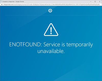

HerveyLee
I am trying to create a new scenario and follow the blog steps in creating a new web hook and new connection.  I am trying to connect to our ArcGIS Enterprise / Portal.  I created the App inside our Portal and put in the App ID and App Secret.  But I keep getting this error.
I do not have Portal Admin privileges and I am a publisher in our ArcGIS Enterprise.
Do we need our Portal Admin to create this connection for us?
JamesTedrick
Esri Esteemed Contributor
Hi Harvey,
Can you confirm that your ArcGIS Enterprise site can be reached from the public internet (say, form your residence without requiring VPN access)?
HerveyLee
I cannot confirm because I don't have that capability.  Do I need to talk to my IT department?
JamesTedrick
Hi Hervey,
If you cannot reach the ArcGIS Enterprise from the public internet (you should confirm with your IT department, but it sounds like this is the case), then you cannot configure the Integromat connector with your ArcGIS Enterprise site.
