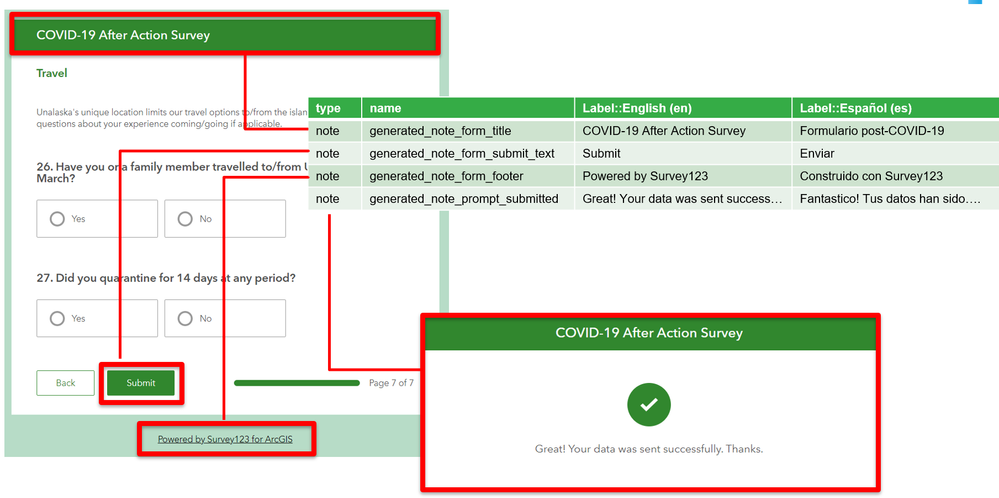

Translating the survey header (title), footer and other elements
There are a number of survey elements that are translated by adding note questions with specific names into your survey design. The next screenshot provides the details:
The survey header (title) is used in both the Survey123 field and web app. The remaining elements (submit button text, footer and thank you screen), are only relevant in the Survey123 web app.

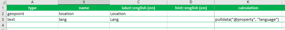

How to tell in what language the user completed the survey
Use pulldata("@property", 'language') to retrieve the language used by the user to complete the survey. You can use this expression in a calculate question for example.
typename       calculation
calculatesurveylangpulldata("@property", 'language')

How would I go about capturing/collecting what language each survey was taken in? We are collecting contact info of people seeking to get the Covid-19 vaccine when it becomes available to them.  If they take the survey in Hindi/Spanish/English/etc. we want to reach out in the same language when their time to get scheduled arrives.
I envision a hidden text field that uses the pulldata function in the calculation field of the survey tab.  After that I'm lost as to how to request the data I'm looking for. Any help would be appreciated. All solution ideas are welcomed.
Thanks! Great feature!
~Becky

@BeckyColwell-Ongenae

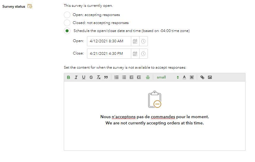

Is there a way to set bilingual text to show when the survey is closed and not accepting new responses? (i.e. the text set on the Survey123 website shown in the attached screenshot)
Perhaps there is a "generated_note" parameter that can be added to the xlsform to set this text in a manner similar to the "thank you" page displayed after the survey is submitted?

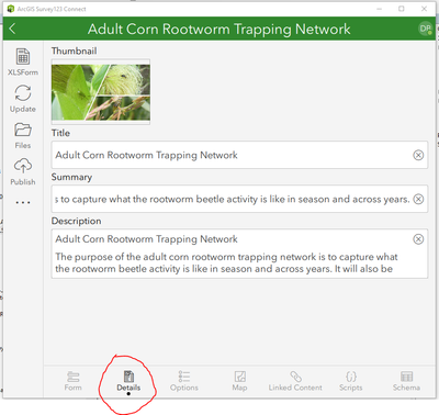

This is a very helpful article.  Is there a way to translate the survey details?  I was able to translate the actual survey (questions and answers) but am struggling to translate the "details".
When I switch to French and make changes, those changes appear in English.  I'd like the details to be in French when French is selected as the language of choice but I have no idea where I can add this translation.
Is this even possible?
Any assistance would be greatly appreciated.

Hello  @IsmaelChivite I copied the suggested calculation for retrieving the language used in the survey:
Then when I go to update the survey I get error "missing calculation"
Any suggestions?
IsmaelChivite
Esri Notable Contributor
@DeclanDevine  You need to put pulldata("@property","language") into the calculation column.
I just tested this with 3.16 and it works as expected. Make sure your survey has multiple languages defined.
DeclanDevine
New Contributor II
Thanks so much @IsmaelChivite.! Actually putting the calculation in the calculation field worked...who would have thought ;).
Thank you!
