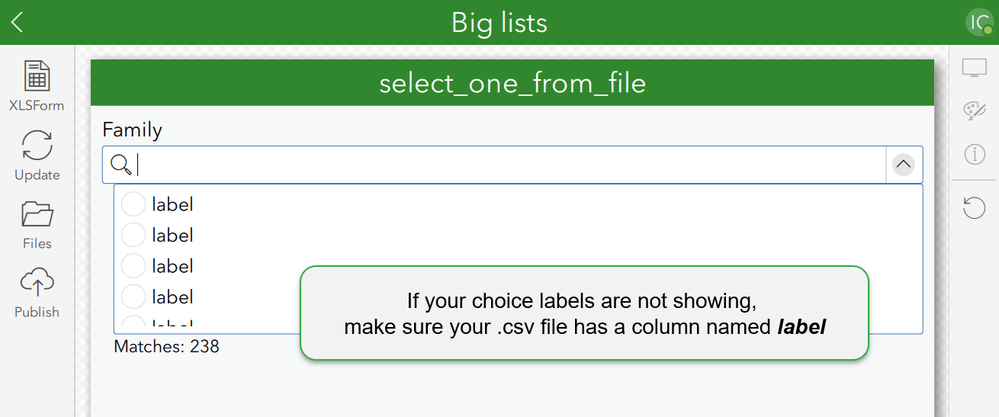

If you ever see Connect display a list like below, unable to display the proper labels, make sure your CSV file includes a column called label. It is common to get CSV lists from other systems lacking a label column. Always remember to rename one of the columns as the label!

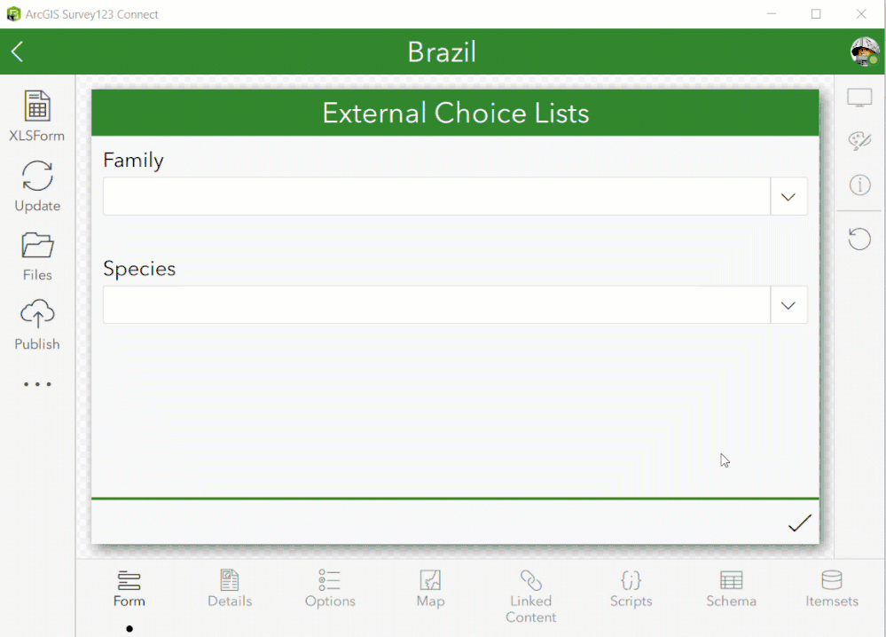

Using the CSV lists in the form design
The list of plant families has barely over 200 choices. It is a very small list, but you got it working! The plant species list has more than 70,000 choices.
You can next publish your survey and try it in the Survey123 field app or in a web browser.

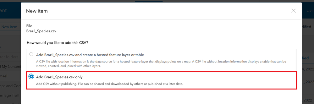

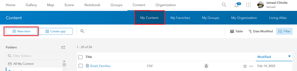

Uploading CSV files to ArcGIS
