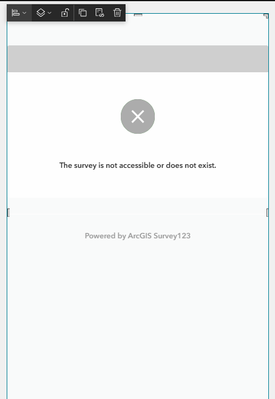

Hi, thanks for the post! I get the attached error when I click on a record in the list, any ideas?Survey123-in-dashboard.PNG

GaryBowles1
I am having issues embedding a survey in a dashboard and experience builder. I am receiving the following error for both:
Enterprise 11.4, survey shared to public, survey owner is admin for portal. I can open the url directly in a browser but not in dashboard/experience builder.
Are we still able to embed S123 in dashboards?
