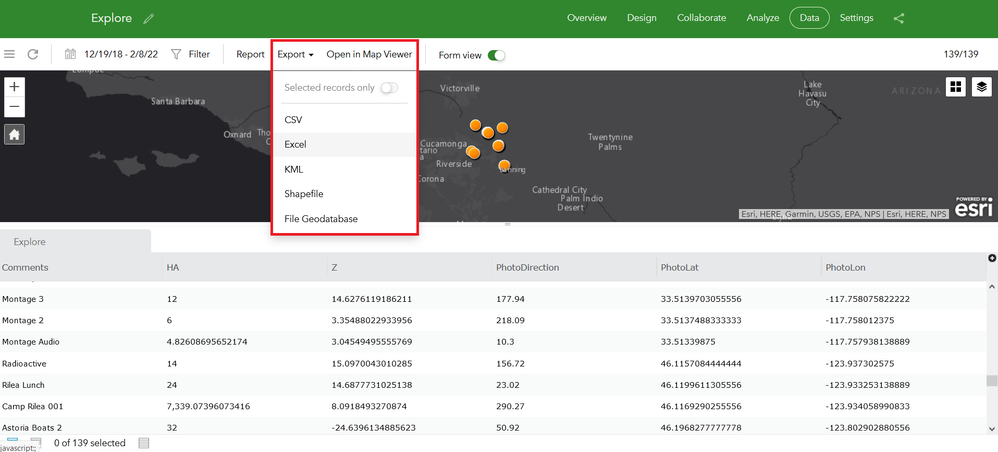

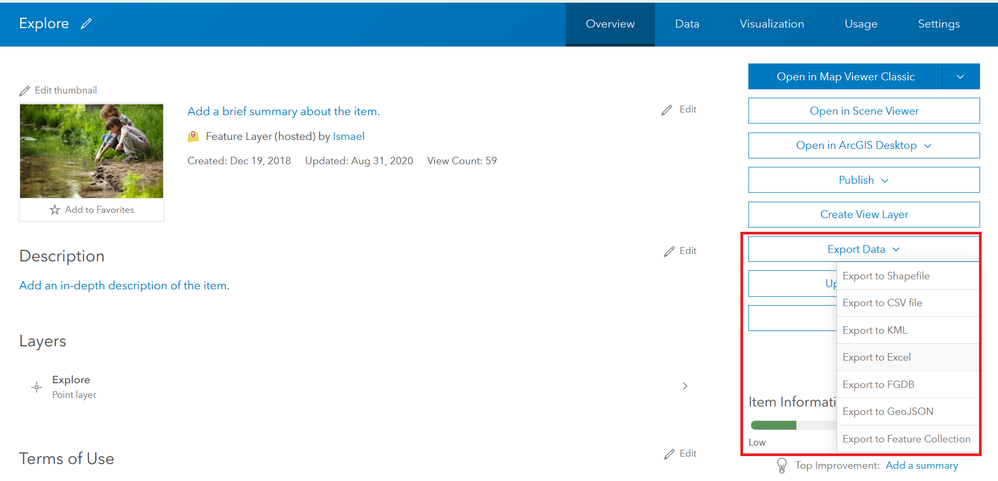

Before we start, let me point out that there are handy Export tools in the Survey123 website. They let you export your survey data as a CSV, Excel, KML, Shapefile or File Geodatabase. You can choose to export all your survey records, or just a subset.
You can also export your survey data from the item details page of your survey's layer item.
The only caveat with these export methods is that you can't download your photo attachments. Technically, you could get your images through the file geodatabase format, but what if you want to export your data and have all your photos in their original format in a folder?   That's what this blog post is about.

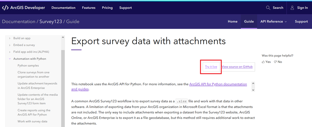

It is going to take a Python script and ArcGIS Pro
Downloading your photos and documents in their original format requires a Python script and ArcGIS Pro. I will describe how to do it step-by-step. Even if you do not have experience with Python, you will be able to do this.
The Python script was developed by @ZacharySutherby  Zach loves Python and he is always looking for new ideas to automate common Survey123 tasks. The script is part of the Survey123 developer documentation.

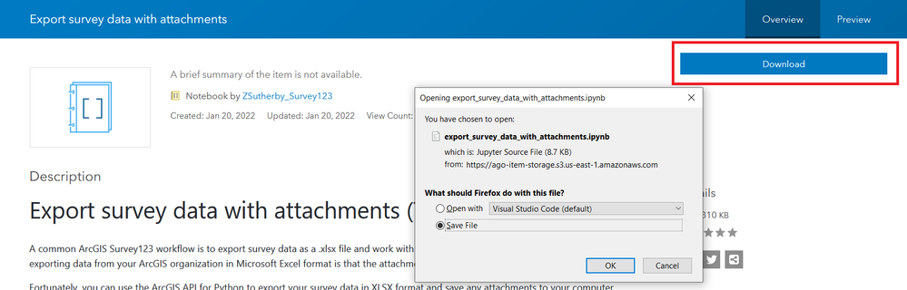

Download data and attachments
  • Click on the Download button and place the .ipynb file into a well-known location on your computer

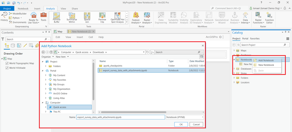

  • Next, open a New project in ArcGIS Pro
  • In ArcGIS Pro, sign in to your ArcGIS Online or ArcGIS Enterprise organization, if not already

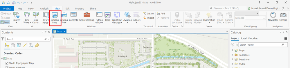

  • Open the View ribbon and make sure the Catalog Pane is visible

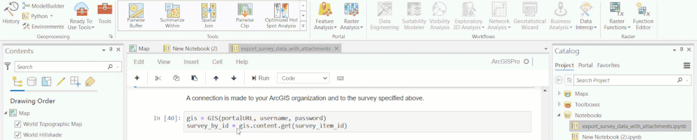

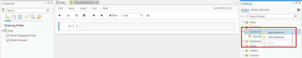

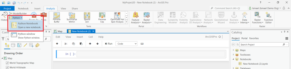

  • Open the Analysis ribbon, expand the Python menu and add a new Python Notebook.

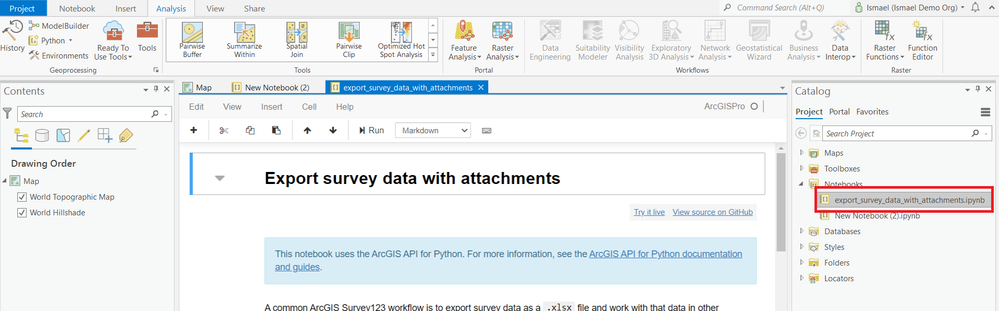

  • From the Catalog pane, right click on the Notebooks category and click on Add Notebook
  • Use the Add Python Notebook dialog to browse for and select the .ipynb file you downloaded before
  • Double-click on the export_survey_data_with_attachments.ipynb notebook

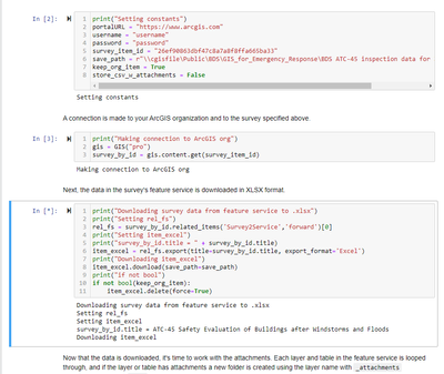

At this point, the notebook will open. With a few minor changes it will be ready to run.

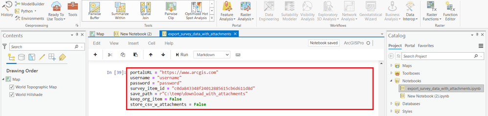

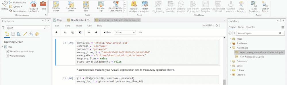

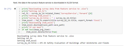

  • Scroll down until you see the second code cell, as shown in the screenshot below
  • Since you are already signed in, you can ignore the first three parameters (portalURL, username, password)
  • The survey_item_id uniquely identifies the survey for which you want to download data. Here is how you get the survey_item_id value:

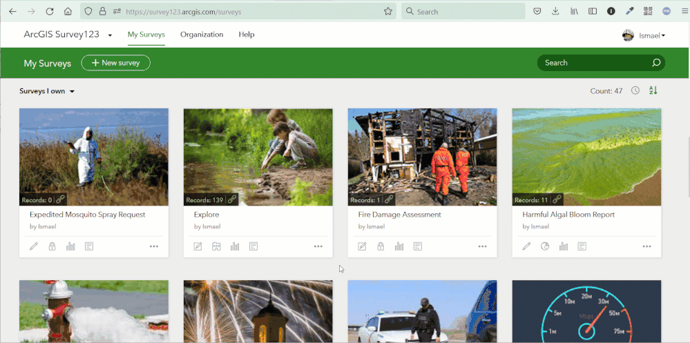

    • In a web browser, sign in to survey123.arcgis.com
    • From the survey gallery, click on your survey
    • Get the survey ID as specified below
  • Now, take your survey_item_id and replace it in the Python code

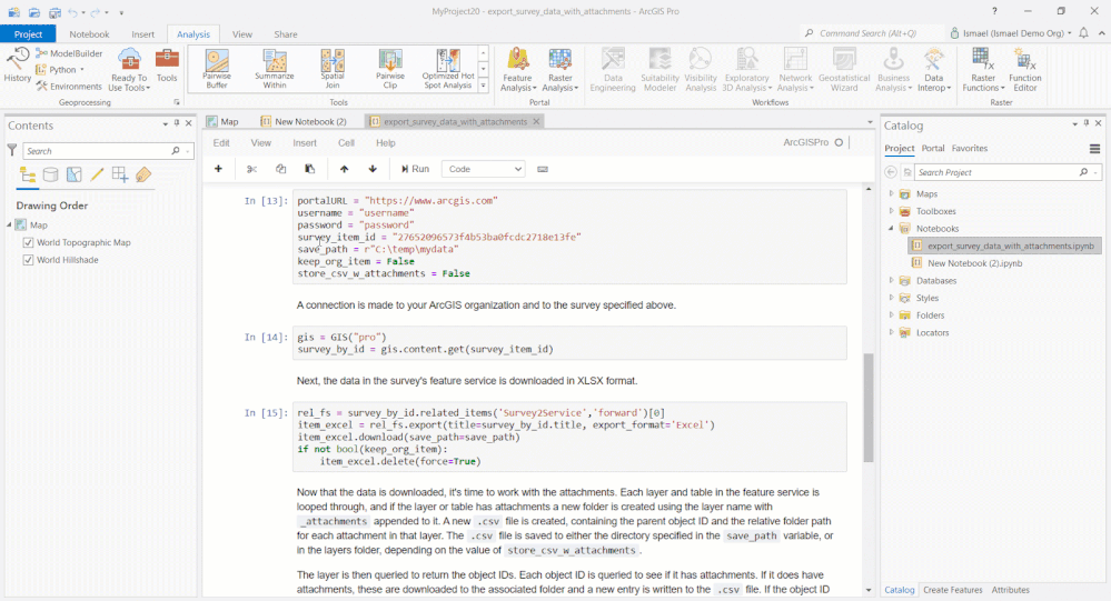

  • Change the save_path parameter so it targets an existing directory in your own computer
Earlier, I asked you to disregard the portalURL, username and password parameters. If you ignored me and set those up, then you can skip the next instruction.  If you left the portalURL, username and password parameters unchanged, then follow the next step
  • In the gis = GIS (portalURL, username, password) line, replace the contents within the brackets with "pro". That is, leave it as: gis = GIS ("pro").  This will essentially reuse the current login information within ArcGIS Pro to run this script and access your survey's data

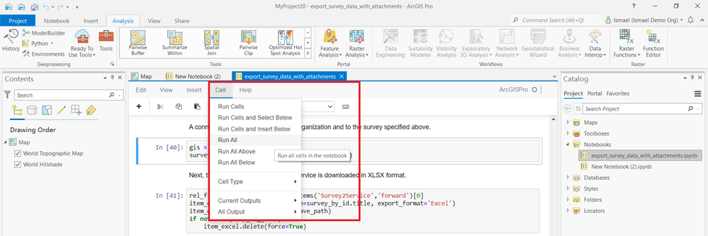

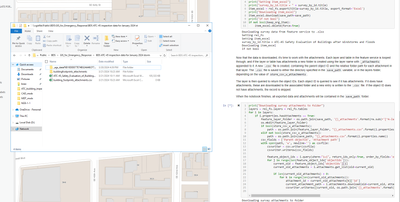

  •  You are now ready to run the script!
  • Open the Cell menu and click Run all
The script takes about 20 seconds to initialize. Be patient.
  • While the script runs, open the target folder and observe how data is downloaded.
    • You will see a spreadsheet created. It contains the records from your survey.
    • You will then see a second spreadsheet describing what attachments correspond to each record. Note that you could have multiple files (attachments) associated with one record.
    • Finally, a folder will be created for your attachments.The script will download photos, signatures as well as audio files any other type of document attached in this folder.
The script has a few other parameters that you can tweak. It is all superbly documented so I do not anticipate you will run into any issues with them.

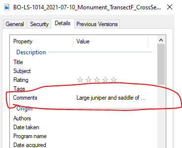

If interested I took it a level farther.  I calculate a image name in the form then use that to rename the image as I export them so they have more meaningful names.  I also create a directory that is the name of the Primary key field as I export so it builds out a meaningful directory structure.
See code here  https://community.esri.com/t5/arcgis-survey123-questions/match-survey123-photo-attachments-to-featur...

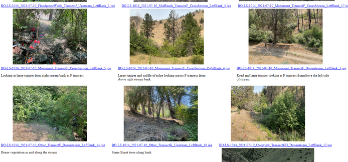

Then in this last project I got more advanced by adding a comment field for each photo in the form.  The script then uses exif.exe to add those comments right into the photo Exif info.
Then for the final step I create simple html pages that have thumbnails for all the photos with the comments from the Exif on the page below the photos.  The thumbnails all link to the full size photos.
Then in our DB we have a link to the web dir / Primary Key / index.html.  These links then launch the little gallery.  Cool thing is this all works even in a Excel export.
See both samples below.  Little more advanced but it came out slick.
Script that renames and adds Exif comments.  Note you need the Exif.exe tool and the Python wrapper called exiftool for this to work.

        # now set the Exif Windows Comment fields to the photo comment
        #skip if comment is blank
        if row[4]:
            jpgFile = baseOut + os.sep + fileName
            with exiftool.ExifTool() as et:
                #jpgComment = et.get_tag("XPComment", jpgFile)
                #print jpgComment
                #newComment = '-XPComment=' + "test"
                # take out special chars
                newComment = '-XPComment=' + ''.join(i for i in row[4] if ord(i)<128)
                #add flag so taht does not crea
                et.execute(bytes(newComment), bytes(jpgFile), bytes("-overwrite_original_in_place"), bytes("-preserve"))

Sample HTML page
hope that helps someone

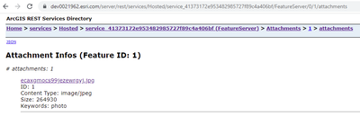

I've moved my survey to Enterprise and now when I query I get no attachments.  I know that Survey123 knows where the photos are.  What is the way to query them now with Python?

ZacharySutherby
Hello @BrandonA_CDPH
On the second line of the fourth code block is where we are exporting the data as an Excel spreadsheet. The code is as follows:
item_excel = rel_fs.export(title=survey_by_id.title, export_format='Excel')
The export method in the Python API supports a "parameters" argument which we aren't using in the sample provided. I believe in this "parameters" argument you can set up a where clause to only export records where [Field] = XYZ.
Please see this documentation for more information on how to configure the parameters, but setting the "parameters" argument to something like:

JamiDennis
@DougBrowning
I am getting the following error when I try to run this script
AttributeError                            Traceback (most recent call last)
In  [13]:
Line 2:     item_excel = rel_fs.export(title=survey_by_id.title, export_format='Excel')
File C:\Program Files\ArcGIS\Pro\bin\Python\envs\arcgispro-py3\lib\site-packages\arcgis\gis\__init__.py, in export:
Line 12855: data_path = "content/users/%s/export" % self._gis.users.me.username
AttributeError: 'NoneType' object has no attribute 'username'
Is it because I am not the form creator? I do have creator rights but I did not create the Survey123 form that I want to download attachments for.
DougBrowning
MVP Esteemed Contributor
Are you hitting a service?  If so you need to be logged into Pro.  Then it will grab your credentials there at the top of the script.
JamiDennis
thanks for the reply, @DougBrowning  yes. I am logged into the portal with the survey through Pro, just as outlined in the article above by @IsmaelChivite

PaulCone2
I'm attempting to run this script, but it just stalls and I'm trying to figure out why.  I added some print statements to see how far it is getting.  It appears to be stuck on
I am running Pro 3.1.3, and can run other notebooks in other projects.
Any ideas?
Paul
DougBrowning
Are you logged into Pro and have this in your script to grab the credentials?
from arcgis.gis import GIS
gis = GIS('pro')
I download to GDB but the rest of my script is this
fsLink = gis.content.get(itemId)
result = fsLink.export("export" + HFSname + dt, "File Geodatabase")
# Save to file system
print ("Saving final downloaded FGDB to {}...".format(out_file))
result.download(backupDir, out_file)
# Remove the extracted FGDB from AGOL (cleanup)
print ("Removing the export file from AGOL")
deleteResult = result.delete()
print ("Delete result is " + str(deleteResult))
hope that helps
PaulCone2
Yes, I have the rest of your script as well.  End users aren't GIS savvy, so they want the Excel.
PaulCone2
@DougBrowning I guess I was being impatient!  Thank you!

PaulCone2
@JMcNultynot sure if this will help, but here is my current code.  I added some print statements to figure out where it was in the script.  It turns out that since my Survey123 feature service includes all the building footprints so I can create a relationship of building to inspection, the script was downloading ALL of them, and taking hours and hours, so I though it was just stuck.  Once I figured that out, I just added another IF THEN to avoid that layer.  This is running in a Notebook in Pro.
print("Downloading survey attachments to folder")
layers = rel_fs.layers + rel_fs.tables
print("for i in layers")
for i in layers:
    print("i.properties.name = " + i.properties.name)
    if i.properties.hasAttachments == True and i.properties.name != 'building_footprints':
        print("i.properties.hasAttachments == True")
        print("Setting feature_layer_folder = os.path.join(save_path, '{}_attachments'.format(re.sub(r'[^A-Za-z0-9]+', '', i.properties.name)))")
        print("Making feature_layer_folder")
        os.mkdir(feature_layer_folder)
        if bool(store_csv_w_attachments):
            path = os.path.join(feature_layer_folder, "{}_attachments.csv".format(i.properties.name))
        elif not bool(store_csv_w_attachments):
            path = os.path.join(save_path, "{}_attachments.csv".format(i.properties.name))
        print("Setting csv_fields = ['Parent objectId', 'Attachment path']")
        print("with open(path, 'w', newline='') as csvfile:")
            csvwriter = csv.writer(csvfile)
            csvwriter.writerow(csv_fields)
            feature_object_ids = i.query(where="1=1", return_ids_only=True, order_by_fields='objectid ASC')
            print("for j in range(len(feature_object_ids['objectIds'])):  ", len(feature_object_ids['objectIds']))
                current_oid = feature_object_ids['objectIds'][j]
                current_oid_attachments = i.attachments.get_list(oid=current_oid)
                if len(current_oid_attachments) > 0:
                    print("len(current_oid_attachments) > 0:")
                    print("for k in range(len(current_oid_attachments)):")
                        attachment_id = current_oid_attachments[k]['id']
                        current_attachment_path = i.attachments.download(oid=current_oid, attachment_id=attachment_id, save_path=feature_layer_folder)
                        print("csvwriter.writerow")
                        csvwriter.writerow([current_oid, os.path.join('{}_attachments'.format(re.sub(r'[^A-Za-z0-9]+', '', i.properties.name)), os.path.split(current_attachment_path[0])[1])])

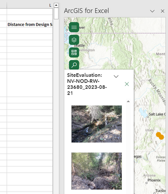

@PaulCone2   Take a look at ArcGIS for Excel.  You can open a service right in Excel directly.  Live time no download.
Then you gave me the idea that the photo can be in a popup in the map on the side.  I think it would work but I cannot test since all my photo forms are in a repeat table.
Maybe someone can test this out.
Answered my own question and its a yes!  Hopefully I can figure out a repeat too.  Really no reason to download anymore.
PaulCone2
@DougBrowning that is a great idea.  As soon as I can get my org to reenable ArcGIS for Excel, I'll try that!  (It got disabled in a recent Office 365 security lockdown.)
DougBrowning
I had luck getting it added as a Managed Addin.
PaulCone2
@DougBrowning ArcGIS for Excel is back again thanks to our Office 365 team.  Yes, works great for downloading into sheets, but then where/how to get to photos, to put in pop-up?  My structure is
