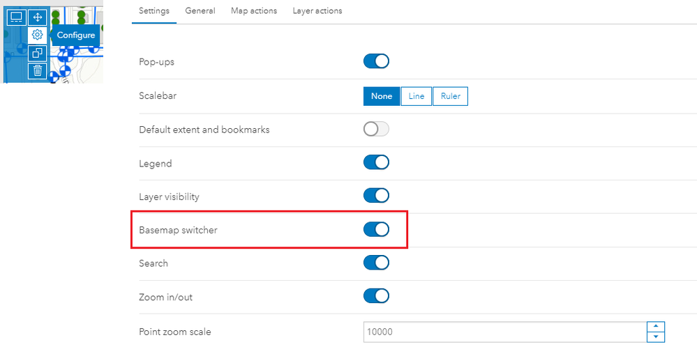

@RyanBohan - If you are trying to disable the Basemap switcher from the main map, click on the Configure settings for the map, and on the Settings tab, uncheck the Basemap switcher.  That removes the option from the top, right of your map.  Hopefully, that is helpful!

@JasminePrater You are correct I am trying to disable the basemap switcher / gallery.  I am looking all over where is the configure setting tab?  Is it something you set in connect?  Or is it located on AGO.  If you could include a screenshot that would be amazing.
  Thank you
JasminePrater
Occasional Contributor II
@RyanBohan  While in editing mode for your Dashboard, click on Configure in the map options (small image in top left), then toggle off the button next to Basemap Switcher in the Settings tab of the Configure options.
RyanBohan
Occasional Contributor III
Hi @JasminePrater thank you for the screen shot.  A picture is worth a 1000 words.  Good to know the basemap gallery can be turned off in Dashboards.  I am trying to remove the basemap gallery in survey123.

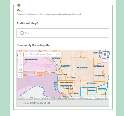

I have published my survey in which one question contains a custom map, in which the participants are asked to map a route. I edited the map myself in ArcGIS online and added some locations  to enable easier orientation.
But the map does not appear in the published survey, it seems to be loading/buffering even after refreshing the link several times. When I switch to the edit-mode the maps appears with all the features that I've added.
Do you know why the map does not appear in my survey?  Thanks!
