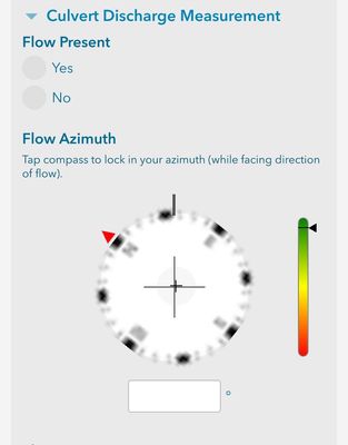

The Survey123 compass control uses the magnetometer in your mobile device to measure the orientation of your device. All you need to do is to align your device with the direction you want to measure. Once you are happy, you tap on the compass control to lock the measurement.
The compass control also includes an indicator on the side. If your device magnetometer is not calibrated correctly, the pointer will move into the red zone.
To add the compass control into a smart form, add a decimal question and set its appearance to bearing. Please note that the bearing appearance is not documented, nor is it included with the Survey123 templates. You will need to type the word bearing into the appearance column manually.
