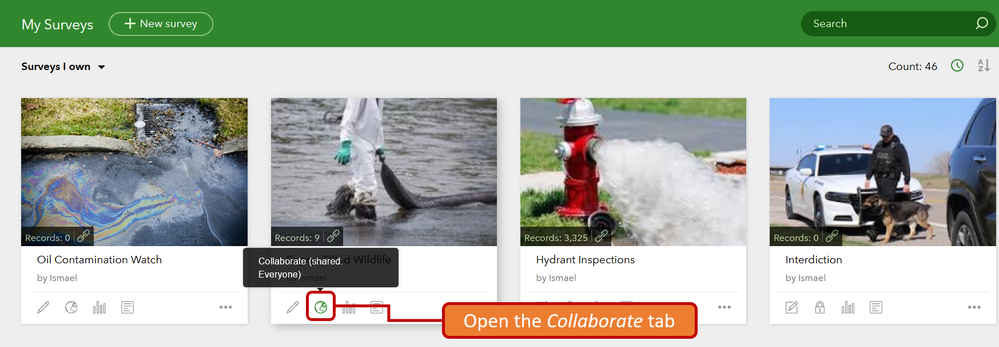

  • Navigate to the Collaborate tab of your survey

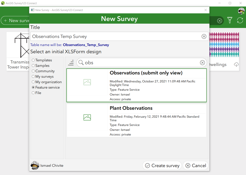

  • In Survey123 Connect, from the survey gallery, click on New Survey and then choose the Feature Service option.
  • Look for the feature layer view you just created and give your new survey a throw-away name, such as temp or delete_me.
  • Open the XLSForm of your temporary new survey and switch to the settings worksheet. Then copy the values in the form_Id and submission_url cells into a text editor or a safe place, so we can paste them later into the original survey.
The submission_url value defines the feature layer (or feature layer view) that the survey is targeting. If empty, Survey123 Connect will create a new feature layer when you publish the survey. If a value is provided, the survey is published targeting the specified layer by the submission_url . The form_id value defines the sub-layer in your feature layer that drives the questions in your survey.

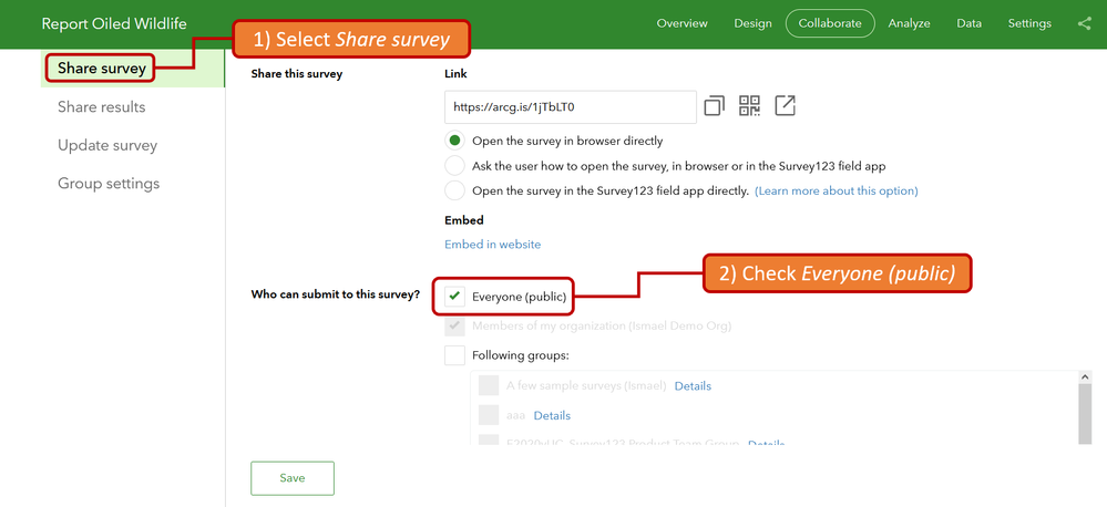

  • From the survey gallery, open the Collaborate tab of your survey
  • The Share survey panel controls who can submit data to your survey. While in the Share survey panel, look for the section named 'Who can submit to this survey?' and check the Everyone (Public) option to share your survey publicly.

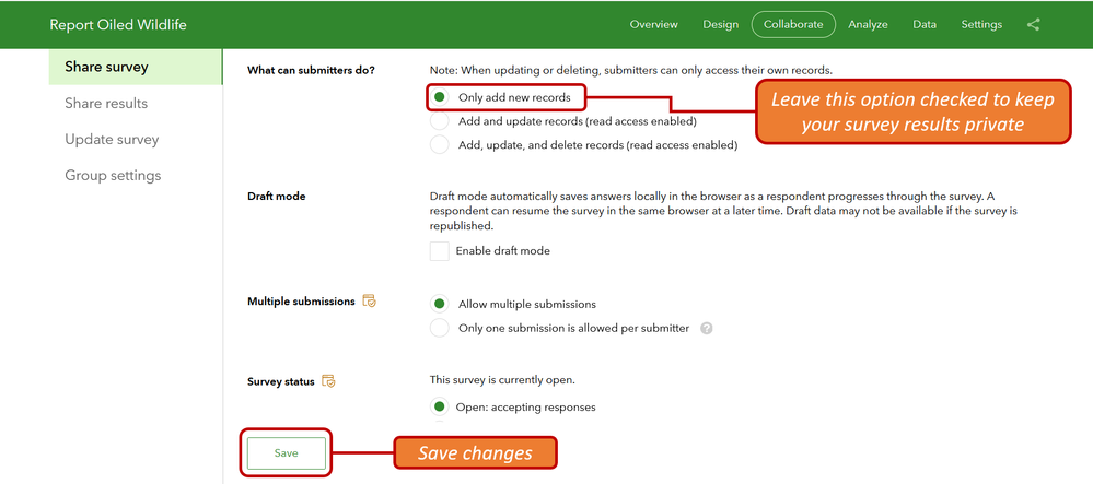

  • Scroll down the page and look for the What can submitters do? section. Note that by default, the selected option is 'Only add new records'. This guarantees that your survey layer will not expose your survey results.
  • Click on Save at the bottom to persist all changes.
At this moment, your survey is shared publicly, allowing anyone to submit data through both the Survey123 web and field apps. You can get the link to your survey from the top of the Collaborate tab and distribute the link with your users. Since you have restricted access to 'Only add new records' in the Collaborate tab, it will not be possible to query, update, delete or download your survey data through the Survey123 web or field apps. Your survey's feature layer will also be secure, preventing any type of access (other than adding new records) from other Esri apps, third party apps or programmatic access.
