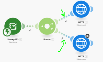

I have some issues trying to set up my Scenario with #Survey123 in way to create a report flow. I need to set up two options, for ADD and EDIT (Update records). Regarding with a ESRI blog, it's important to set up a filter router. If I only set up the scenario for ADD, it works perfect, but not for EDIT.
Maybe any advice on how to deal with this problem?
Thanks!
MichaelBruening

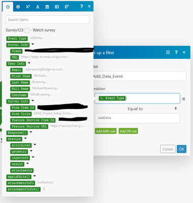

@MauricioGiraldo this is just a guess, but have you tried placing a "router" before the two branches of your scenario and then add a filter to each of the two branches for "add" and "edit"?
For example, below you could apply a filter in between the router and the top HTTP for the "add" data event scenario. Then you could apply a separate filter in between the router and the bottom HTTP for the "edit" data event scenario. I would set both filters to only allow the scenario branches to continue if the filter passes a "true" result for each filter. Event Type = addData or Event Type = editData.

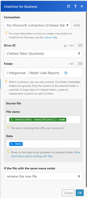

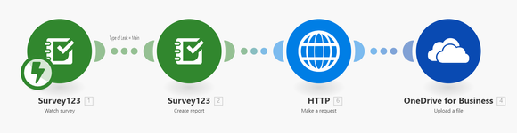

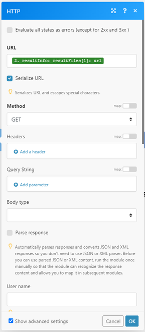

@RobertBowers  This is an old post, but I thought I would share my solution in case someone else runs into the same issue.
I was able to remove the 'UTF-8' prefix from file names in OneDrive by using the 'Make a Request' HTTP action instead of the 'Get a File' action.
Here's how I have the HTTP and OneDrive modules set up:

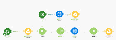

Throwing my experiences in here in case it helps anyone.
1. I have surveys that feed our Workforce projects. When the public or our dispatchers submit a survey, emails get generated to the appropriate people
2. A good example of attachment setup is our special events scenario, where multiple modules can provide attachments and we need to get those into one email

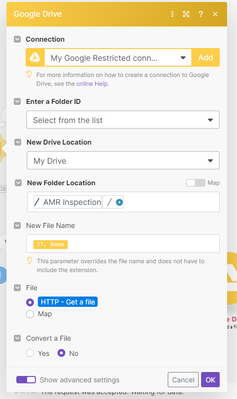

UTAHOGM_GIS
I am working on a long term data collection project.  I have the Survey123 form created and have almost everything I need in integromat created.  Part of this project is the form and images from form need to go into their own folders.  I used integromat to create a folder to google drive.  I have checked google drive and the new folder is located where it should be.  The problem I am having is after the survey form has been converted to pdf I try to send the pdf to the new folder I created.  I am now having file not found errors.
Seeing if anyone knows how I should label my New folder location
