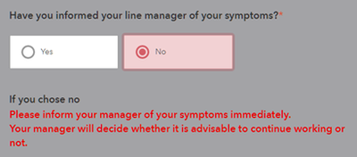

I created a Covid Health Screening form for my company, it is a public survey. If an employee notes any symptoms, they are to inform their line manager. For this Yes /No Question, I would like to insert a trigger email notification, is this possible?

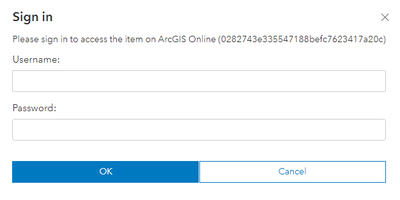

Hello - I am experiencing a new issue with a Survey123 form that I have shared publicly and set to open in the web browser. When folks click the link or scan the QR code for the survey, they are prompted to "sign-in to access the item on ArcGIS online". Since the survey is shared publicly, it shouldn't require a sign-in. And in fact, if the user clicks the "X" in the upper right corner of the pop-up (twice), the sign-in box goes away and the user is able to enter information into the form without signing in.
To eliminate confusion, I would like to eliminate this pop-up box. How can I do that??
