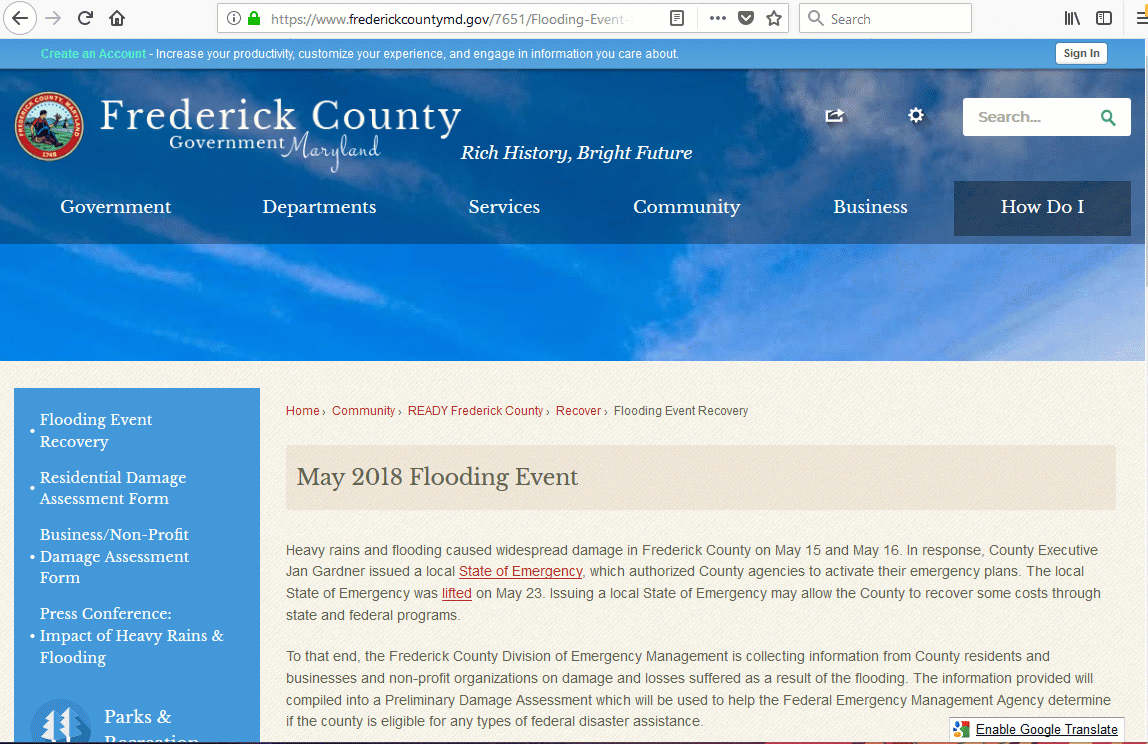

In the following example, you can see how Frederick County, in Maryland, provided a public survey for citizens and businesses to report property damage and loss after a flash flooding event in May 2018.  Public surveys like this can be put together very quickly and help you gather information right away.

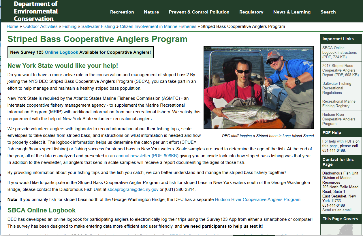

The New York Department of Environmental Quality offers a logbook so anglers can report stripped bass catches to help protect the fishery.  The logbook was made with a Survey123 made public, which gets downloaded into the Survey123 app.   This is part of the Stripped Bass Cooperative Anglers Program.

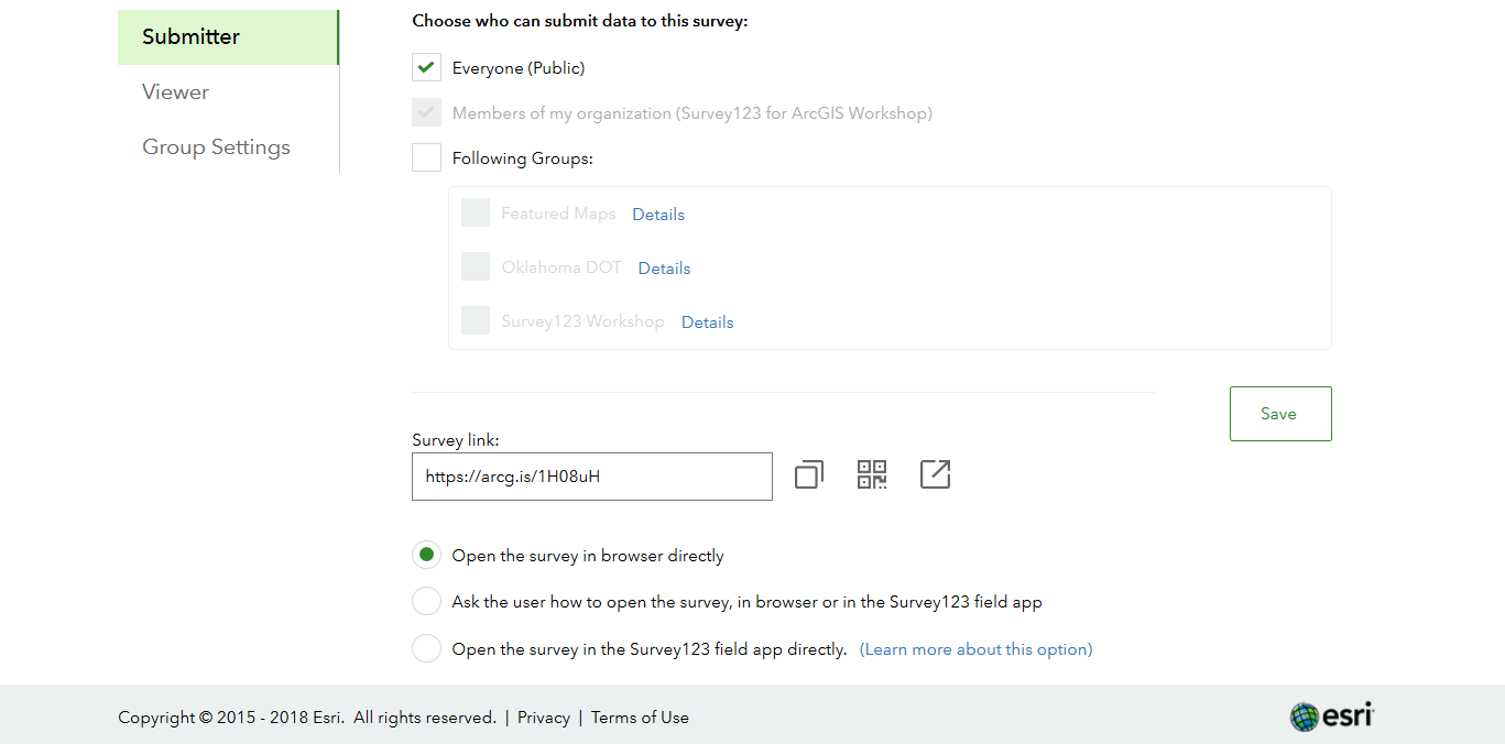

Making a survey public is straight-forward. First go into the survey123.arcgis.com web site and select your survey from the gallery.  Open the Collaborate tab and share the survey with everyone.
If the option to share with everyone is not shown, then either permissions to share with Everyone have been revoked from your ArcGIS account, or sharing with Everyone has been disabled in your ArcGIS organization all together. Ask your ArcGIS administrator for details.
Sharing your survey with everyone is just a first step. If nobody knows about your survey, nobody will contribute data to it. Keep reading to understand how people can open your public survey.
How to promote and open a public survey?
From the Collaborate tab, you can easily obtain URLs to open your public survey.
You can use the survey URL to create HTML links in your own web site, or include them in e-mails, blogs etc.  Note that you can obtain URLs that will open your survey in a web browser, or alternatively URLs that will automatically open your survey within the field app.

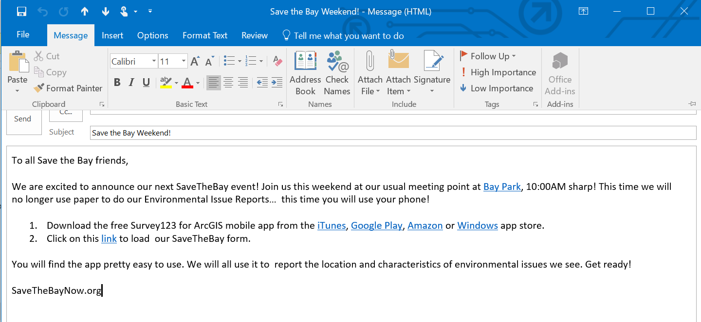

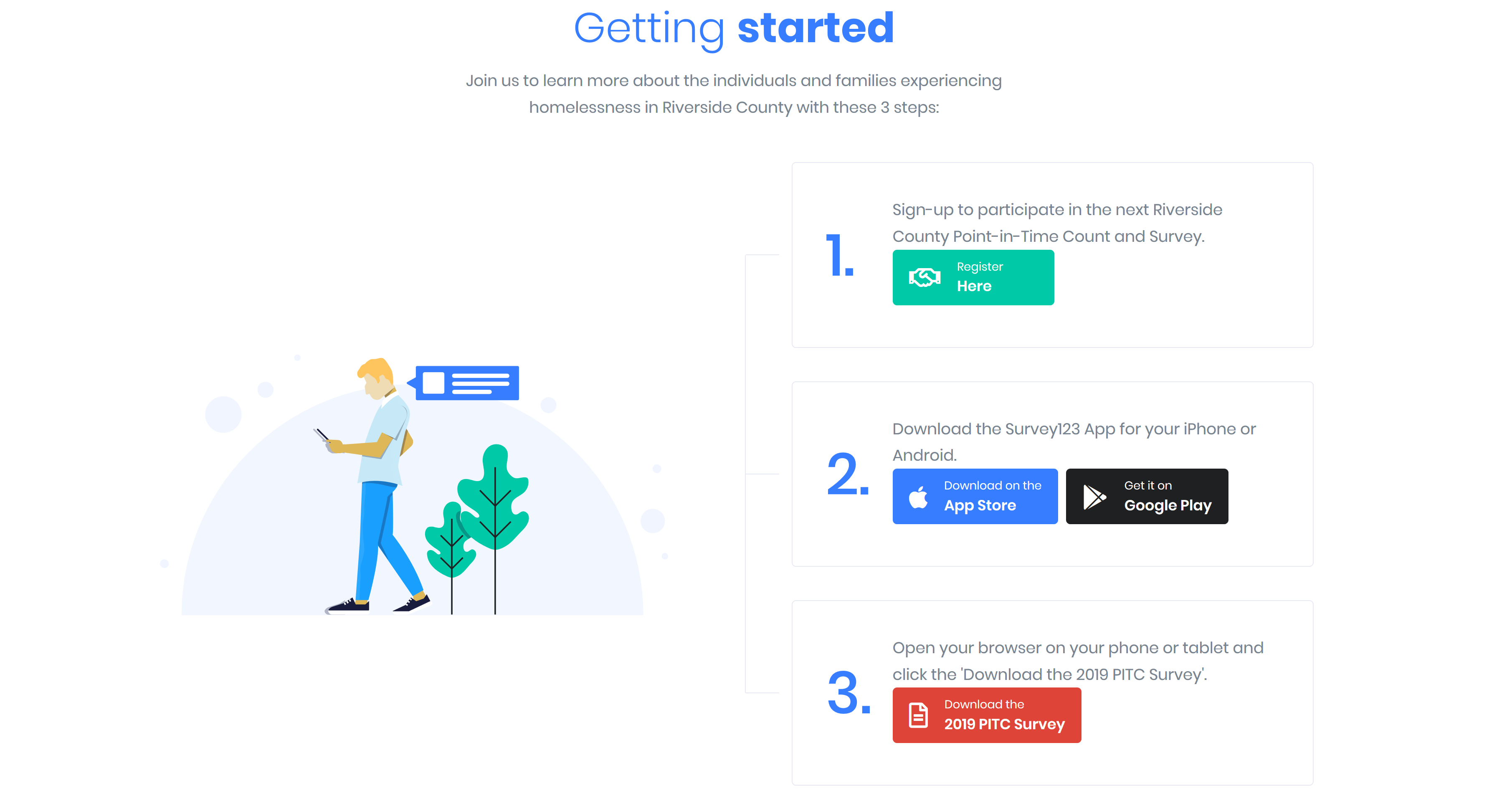

Your survey in the Survey123 field app: First of all, for the Survey123 field app link to work, you want people install first the Survey123 app. In the next screenshot for example you can see how we encourage people though an invitation email to download and install the app first.  You will also observe that the URLs provided from the Collaborate tab have been embedded in the e-mail as HTML links.
If you decide to promote your public survey through a web site, you can follow a similar approach: Tell people to download the app first, and then load the survey. Here is an example from the County of San Bernardino, in California.

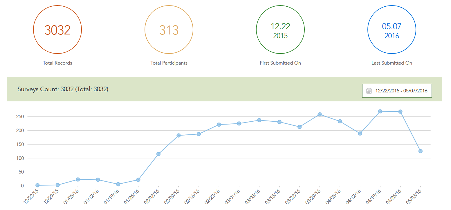

You can track the activity of your survey' contributions by using the Survey123 website. The Overview tab will give you key stats:
The Survey123 website lets you quickly understand when data is contributed and by who
The screenshot above illustrates one of the several ways in which the Survey123 website will help you  understand contributed data. The line chart shows the number of surveys submitted over time.

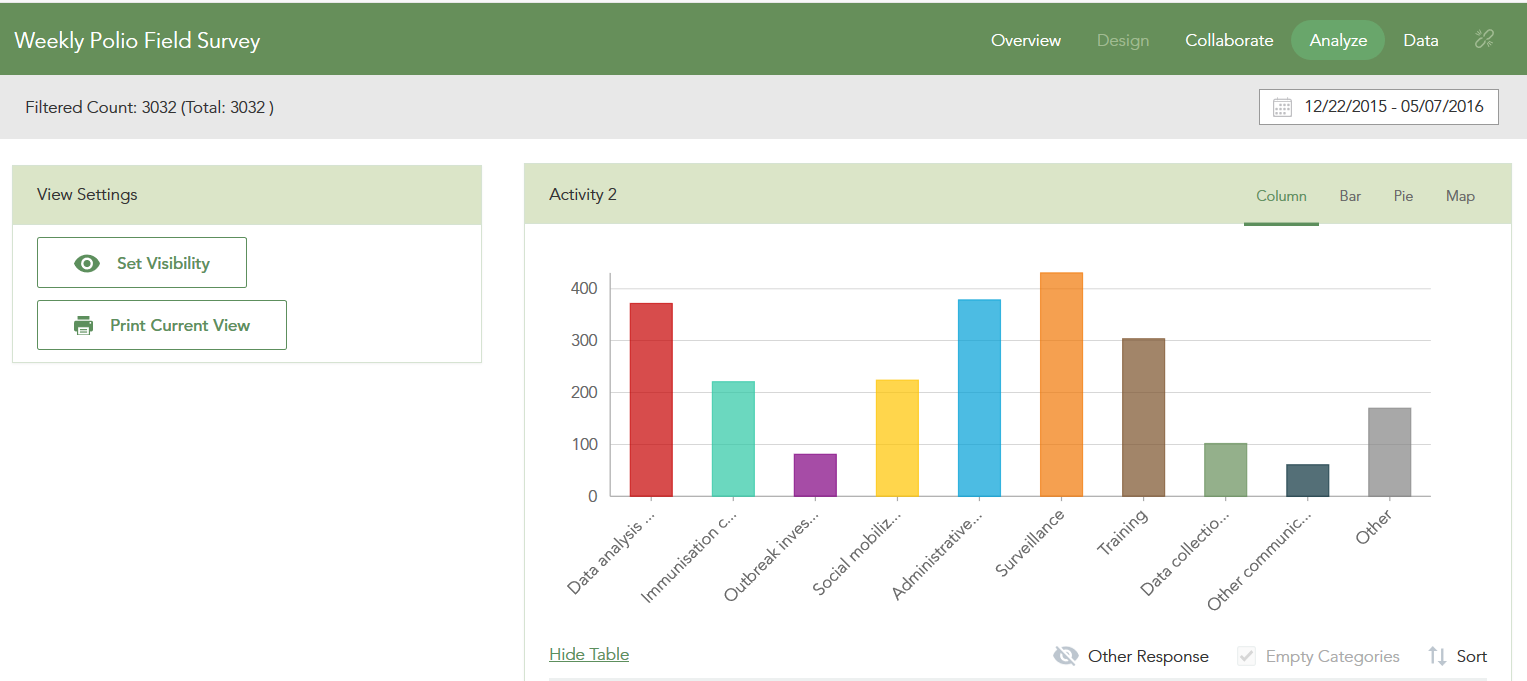

Below a view of the Analyze tab, which summarizes every question added to your survey.  There are multiple options to control how the information will be visually represented (as a bar, pie or column chart as well as maps) as well as filters to display the specific questions and time windows to be summarized.
From the Survey123 website you can also download the data of your survey in CSV, Shapefile and FileGeodatabase formats.

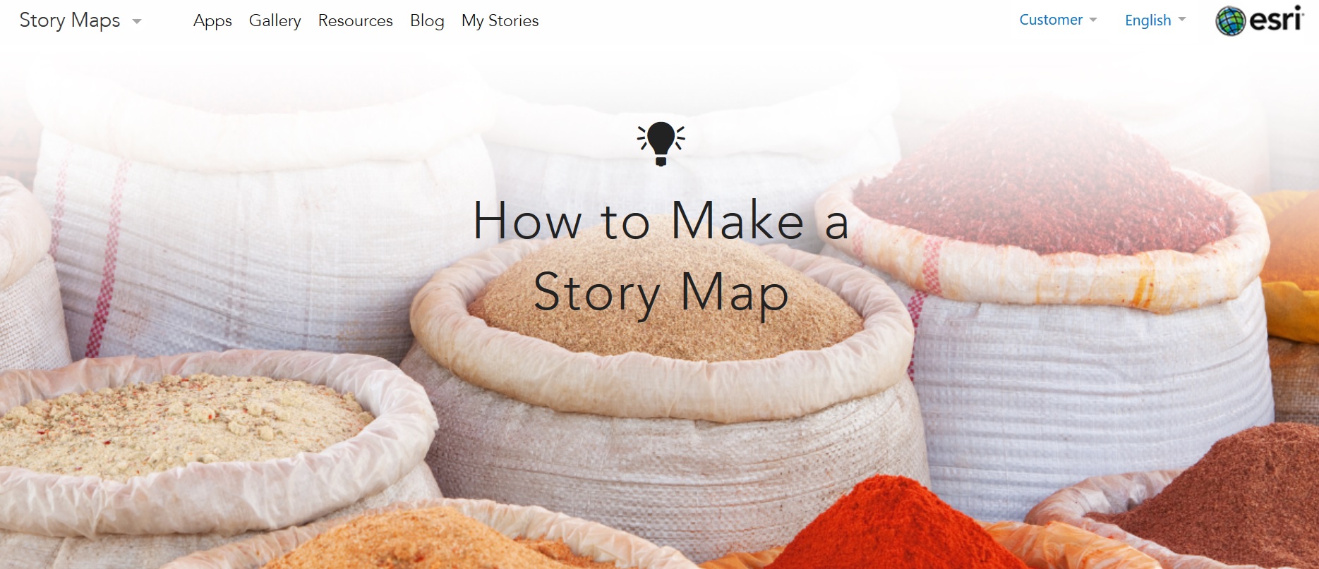

The Survey123 website gives you several options to understand contributed data, but at some point may want to also share the results of your work. I personally like the use of Story Maps, Web AppBuilder and the Configurable Application Templates included with ArcGIS.  All submitted data to a survey is kept in a feature layer, which you can use from any of this apps.
This quick video can give  you some ideas to get started. One of my favorites to make  the results of your survey shine is Story Maps
