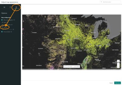

OwenGeo
Esri Notable Contributor
We have an update on this issue.  
We have determined that this issue affects some stories that contain maps with the legend turned on.
If you have an immediate need to fix your story, you can turn off the legend widget in any maps where it is enabled and this should resolve the issue.
We are working to deploy a patch to resolve this issue for everyone soon and will post an update here when we have more information about the timeline for this.
We again apologize to those of you who have been affected by this issue.

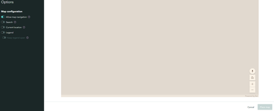

BrandonCrafword
Turn off the legend didn't work for me either. I could turn it "off" in edit, but I'm then unable to "place map" so I effectively am blocked from updating the map (see grayed out "place map" below).
