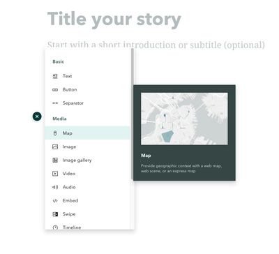

ArcGIS StoryMaps is a no-code product. You use an interactive builder to add your stories, which can include text, media (images, video, audio), embedded web content, and maps. You can create maps directly in the story builder (these are called express maps) or embed web maps or web scenes created in ArcGIS.
While in the story builder, click the plus sign (+) to insert content and choose Map. Then you'll see a browser where you can see maps from your own content and your organization.

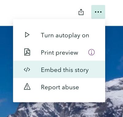

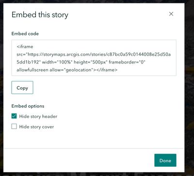

Once you create and publish a StoryMap, you can embed it in another web page, if you like. You can get the embed code from the ... menu when viewing the published story.
