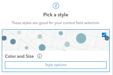

ArielLow2146
@BernSzukalski thanks for the update! Unfortunately I need to style my layer using color and size.
Based on your response it sounds like changing the pop-up chart color when using this type of symbology is not currently possible, is that right? If so, do you know if/when that might change?
Currently my layer is using a grey/blue color ramp which is important given the subject and having orange charts is a little jarring.

It's not supported across all styles. The ones that do support it are the predominant category and predominant category and size, and charts and charts and size. And with those, the chart element colors are automatically set to match the style - you can't change them.
Chart color customization is on the to-do list, but TBD when that might happen.

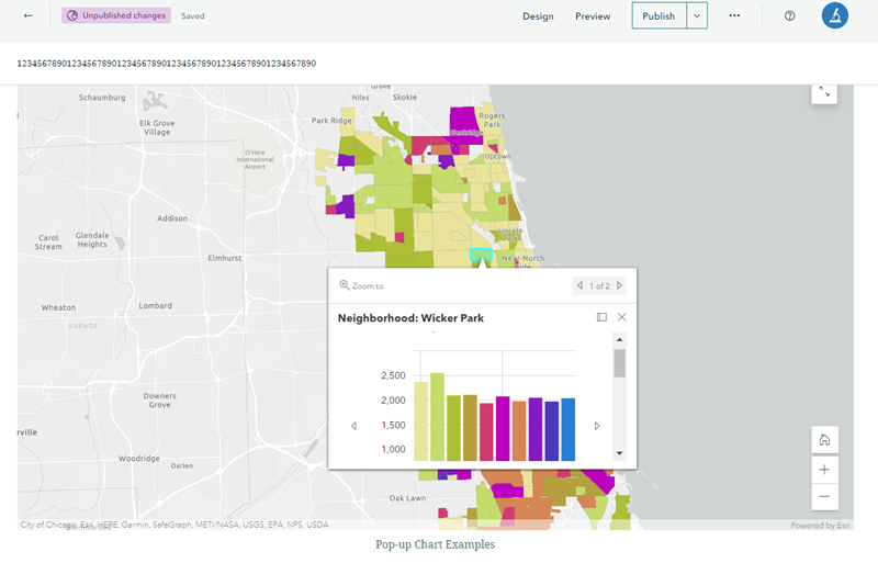

BernSzukalski
Esri Frequent Contributor
I forgot to add that those chart colors in web maps made with Map Viewer will absolutely display in ArcGIS StoryMaps. Here's the above map in a test story.
