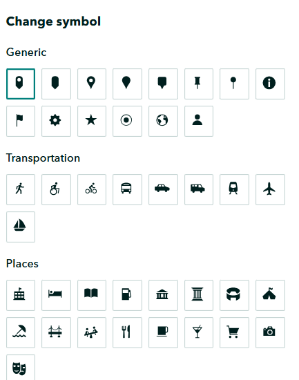

AstridF
It would be great if there were an option to add our own custom icons instead of the generic ones — especially for the Map Tour layout (when starting from an existing feature layer). We often need more detailed or complex icons than what’s currently available.2025-11-12 21_48_21-Inbox - Astrid.Faminialagao@tcdc.govt.nz - Outlook.png

OwenGeo
Esri Notable Contributor
@AstridF - Thanks for sharing this feedback. We have considered looking into this, but we do not have custom icon upload on our roadmap at this time. It would be great if you could please add this as an idea on the Ideas Board so others can comment and vote for it if they would also like to see this feature added.
We currently use Esri's Calcite icon library and are looking at adding more icons from that in the near future. If there are any icons in either of these lists that would be helpful to you, please let us know and we can look at adding them soon.
If the type of icons you are looking for are different, please share details of what type/style you are looking for in the idea you post on the Ideas Board.
