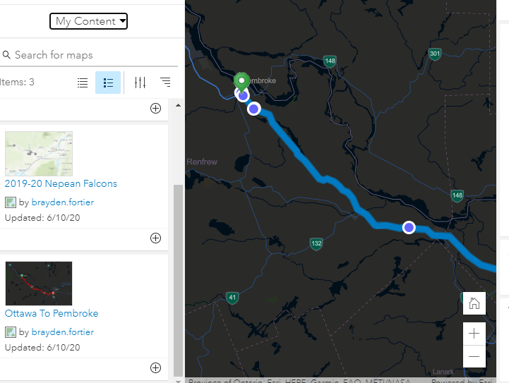

I am getting a similar result here. When I select "Open existing map" I see all the maps my son has in his content. The image for each map is the map we stylized ourselves, but when the map opens it has all of the components of the route layer included.
Is there a workaorund for this?
RyanFortier
On the left is the map I selected, however it opens with the the original route layer symbology on the right.

RyanFortier
When opening the map with the beta viewer it displays the map with the orginal route layer, but when opening in the older 3.x version, it opens with the  my son and I created.
The screenshot I provided you was the beta viewer, however I selected the "open existing map" on the left side pane. The map I selected to open and the map that actually loaded were not the same.
