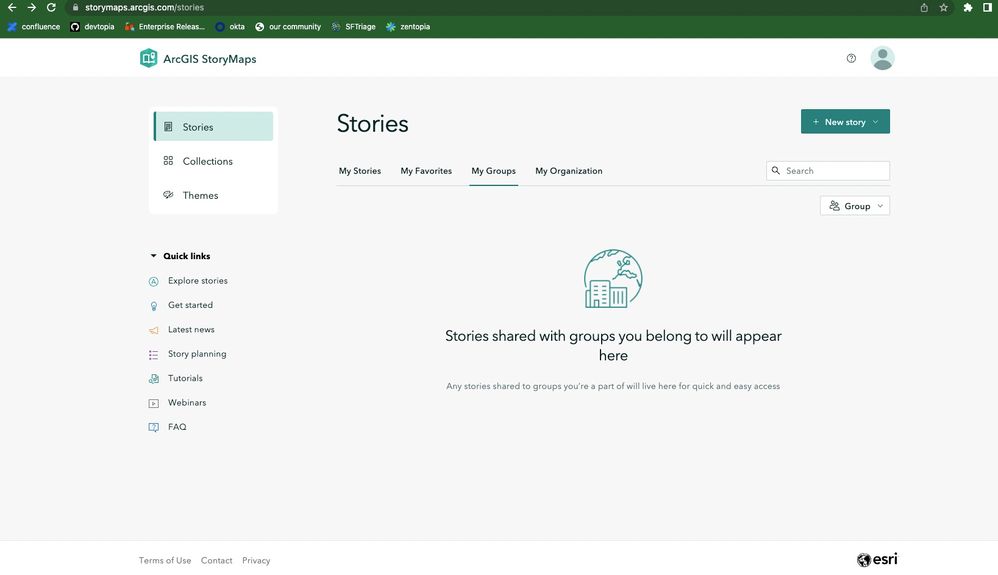

  • You can share each of these stories to a group, which then can have all stories shared with groups the user is a part of appear on the My Groups tab:

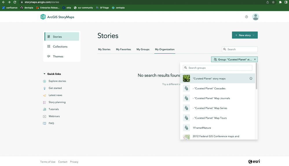

  • This could also be done by sharing to the organization level and using the My Organization tab, if all users within the organization would be looking to see all stories within the organization.
You also mentioned having a review process between a user and facilitator. This could be done by having a user share their story to a "facilitator" group, where the facilitator reviews the stories in this group and, once approved, shares to a "Gallery" group. This Gallery group could either be filtered on the Organization page (screen shot below), or the group could be referenced in another site, like ArcGIS Hub. That part would depend on where you are looking for these users to access this gallery.
