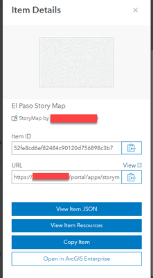

Hi @RobinRutten_ams, which AGOL Assistant are you using?  I recommend the new one as it allows you to view the Item Resources:
I wrote some migration tools that copy a Story Map from Org to another that may be helpful.  You can take a look at the Copy Story Maps.py script to see how to update the Item Resources, and also how to publish the Story Map.
