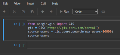

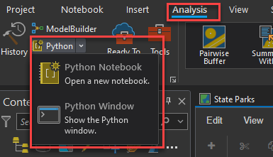

@Eliot_Reid
Open the python console, or new Notebook in Pro by going to Analysis tab > Python dropdown:
Enter the following code, replacing https://gis.esri.com/portal with your URL to portal:
from arcgis.gis import GIS
gis = GIS('https://gis.esri.com/portal')
source_users = gis.users.search(max_users=10000)
source_users
 Ex:
Does this execute successfully?

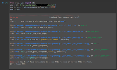

Eliot_Reid
It does not, same error.
I just double checked and our Portal security actually says SAML is set up, not IWA. I assumed they were the same thing. I'm not sure if they work the same.

@Eliot_Reid I had a feeling this may be the case.  SAML is not supported.  If you can, create a built-in Administrator account and use that instead.

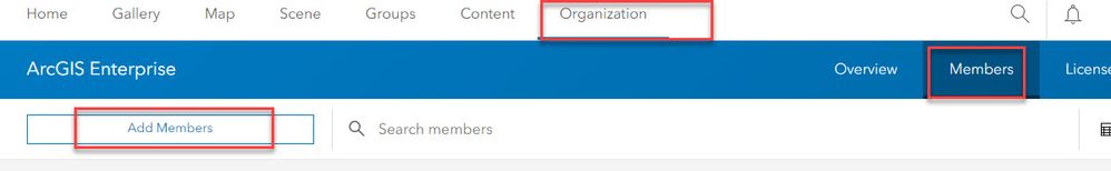

anonymous55
@JakeSkinner

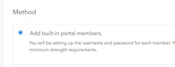

I am getting same error as @Eliot_Reid could you help me how can I fix this error? How can I create  a built-in Administrator account? I am admin in our portal org
Best,
JakeSkinner
Esri Esteemed Contributor
@anonymous55 go to Organization > Members > Add Members:
There you will have an option to create a Built-in account:

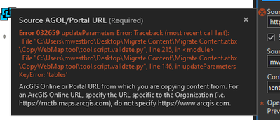

MichaelWestbrook

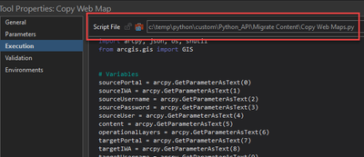

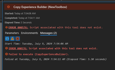

@JakeSkinner  I'm trying to use these tools but when I run it I get this error :
Any ideas?
JakeSkinner
@MichaelWestbrook right-click on the tool you are trying to execute and click on the Execution tab on the left.  It will list the path to the python script.  Make sure it exists in the path referenced here.  Ex:

MichaelWestbrook
@JakeSkinner  Good morning, I am trying to copy web maps and as soon as I select the web, PortalUrl gets an error
JakeSkinner
@MichaelWestbrook I found the issue, the validation code checks the web map for tables, if none exists, it produces this error.  Redownload the tools, and it should work successfully now.
MichaelWestbrook
@JakeSkinner  Works perfect now! Thank you!

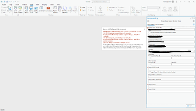

MichaelWestbrook

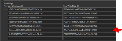

@JakeSkinner I copied the web maps over successfully. When I copied the Experience Builder it ran successfully but out of the 7 web maps in it, it only mapped one successfully.
JakeSkinner
@MichaelWestbrook I've seen sometimes if you don't tab out of each Web Map ID box, the GP tool won't pick up the IDs correctly.  Try tabbing out of the New Web Map ID and re-run the tool again to see if it works.

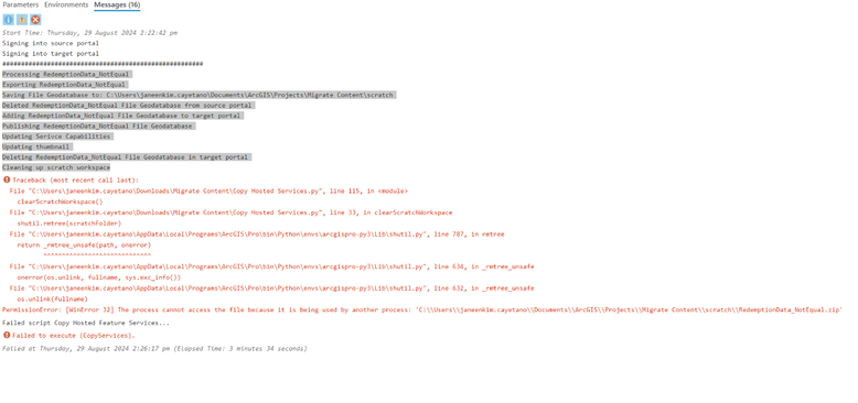

jdcayetano
The transfer worked but I was wondering if this error meant something that I need to be wary of:

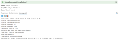

CommunityMapsEsriColombia

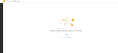

Hi @JakeSkinner , I'm trying to migrate a dashboard from my ArcGIS Online account to an ArcGIS Portal 11.1 account, apparently the tool works fine but when I check the item it is empty. I even checked the .json through assitant and it has the dashboard structure copied. Do you know how I could solve this problem?
PD: I am the administrator of both accounts.
CommunityMapsEsriColombia_0-1724951103846.pngCommunityMapsEsriColombia_0-1724951103846.png
CommunityMapsEsriColombia_1-1724951199572.pngCommunityMapsEsriColombia_1-1724951199572.png
JakeSkinner
@jdcayetano no, this should not be a concern.  The script did not delete a temporary zip file mentioned in the path above.

JakeSkinner
@CommunityMapsEsriColombia migrating from ArcGIS Online to Enterprise will not be supported.  ArcGIS Online is always at a later release than Enterprise, so applications will fail to open.  What should work is migrating Web Maps and Hosted Feature services from AGOL to Enterprise, but I have not extensively tested this.  Ideally, you should only be migrating content between the same environments (i.e. AGOL --> AGOL, Enterprise 11.1 --> Enterprise 11.1).

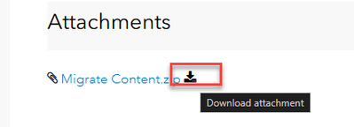

Furthemore the zip is not downloadable anymore. looks like it is disabled
JakeSkinner
@VigneshGopalakrishnan the tools may not work for migrating Experience Builder applications between different environments.  This should work for hosted feature services, and web maps, but there could be significant changes in applications that are not supported between different versions.
Make sure you click the arrow to download the zip file:
