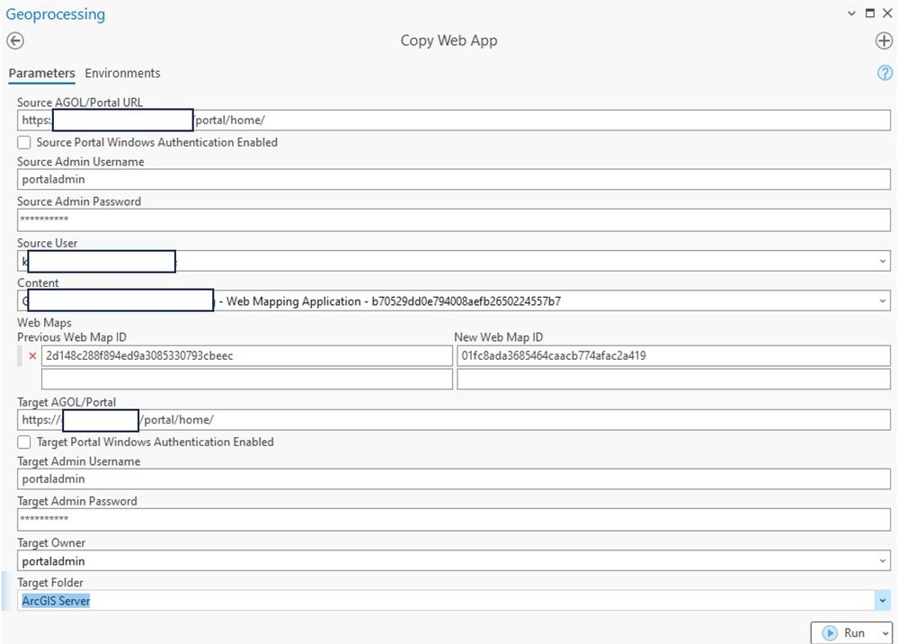

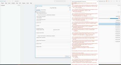

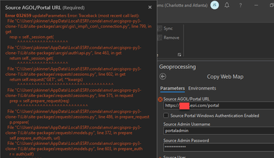

@denisCallens from you screenshot, it appears you are connecting without specifying a username/password, so you wouldn't be using a built-in account.  Can you send a screenshot of your Logins by going to Portal > Organization > Settings > Logins:
denisCallens
Here are my login settings
JakeSkinner
Esri Esteemed Contributor
@denisCallens can you send a screenshot of how you are authenticating using the tool in ArcGIS Pro?

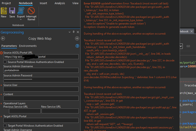

denisCallens
Here it is. My active portal in AGP is the source portal
Here is the full error message
Error 032659 updateParameters Error: Traceback (most recent call last):
File "D:\ARCGIS\cloneEnvi\240620\lib\site-packages\arcgis\auth\_auth\_token.py", line 802, in token
self._init_response_type_token()
File "D:\ARCGIS\cloneEnvi\240620\lib\site-packages\arcgis\auth\_auth\_token.py", line 551, in _init_response_type_token
raise Exception("Unable to generate oauth token")
Exception: Unable to generate oauth token

JakeSkinner
@denisCallens did you change the validation code?  It looks like you're receiving a different error (i.e. Unable to generate Oauth token).  This error should not be generated when using built-in credentials.  Below is the error I'm receiving when specifying invalid credentials:

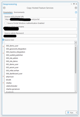

denisCallens
Hi @JakeSkinner
I didn't change the code but to be sure I downloaded the toolbox again.
No more success but i notice something odd:
In the "copy web map" tool,
  • I insert my portal url, my source admin username and source admin password
  • When I clicked in "source user" field, the "source Admin Username" disappears.
Then, if i fill my username again, i am back to the error message I sent last week.
JakeSkinner
@denisCallens in the Python 3 command prompt, ArcGIS Pro Notebook, or Python IDE, try executing the below code:
from arcgis.gis import GIS
gis = GIS('https://dns.domain.com/portal', 'built-in-user', 'password', verify_cert=False)
Does this work successfully?

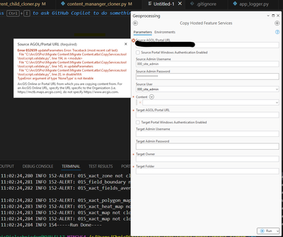

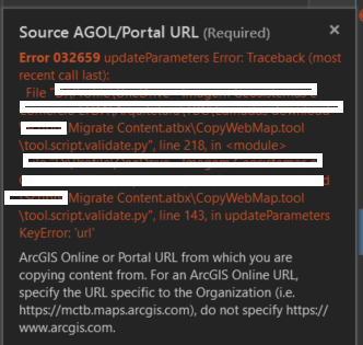

chris_del101
I keep getting error when I try to login to the tool. I am copy pasting my credentials so they are 100% correct. I've also tried manual entry so it's not due to extra characters, etc.
It was working for a period before this occurred so this makes it even more baffling - that it stopped working
Exception: A general error occurred: Too many invalid attempts. Please try again later.
Obv the creds in the photo are phony, but the error output is the same.

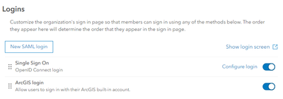

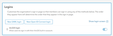

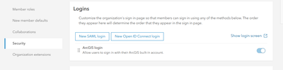

@chris_del101 what type of security are you attempting to sign in with (i.e. Built-in, Active Directory, SAML)?  Only built-in and active directory are supported.  Check the comment above your last one that has a python snippet.  Does this work for you?
chris_del101
@JakeSkinner Thanks for response.
It fails with the same error, but not always.
If I am getting this failure, why is it not failing 100% of the time? I closed and reopened and it connected again. Open/close doesn't look like silver bullet though since it doesn't always fix it.

1.  Can you send a screen shot of Portal > Organization > Settings > Security > Logins:
2.  Is there an '@' symbol in your username?  For example, jskinner@ESRI.
3.  Check the casing of your username.
4.  What version of ArcGIS Pro and ArcGIS Enterprise are you running?

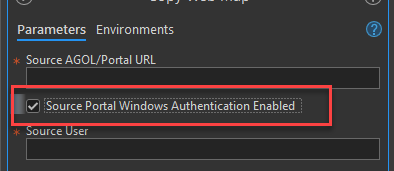

JakeSkinner
@denisCallens do you have Windows Authentication enabled on Portal's web adaptor?  If so, you need to check the box highlighted below:
This will remove the username/password parameters and attempt to authenticate using your windows credentials.
denisCallens
Hi @JakeSkinner,
I have single sign on via OpenID Connect login (see screenshot below). I tried with the box checked. Same error.
Earlier you mention that portal with SAML authentication has to use built in user. This why I try this way.

denisCallens
Hi @JakeSkinner,
I come back regarding the issue I report last month.
I couldn't be authenticated with built-in user. There is a webtier authentication via SAML on my portal.
I get the following error:
Exception: A general error occurred: Expecting ',' delimiter: line 1 column 627 (char 626)
 After a lot of searching I found on a GitHub page (https://github.com/Esri/arcgis-python-api/issues/1712) the following suggestion : "Adding "use_gen_token=True" parameter fixed this issue for me"
I added this parameter every time your script call GIS class. See below for example.
This does the trick, and your tool works with my portals.
Thank you for this great piece of work.

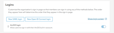

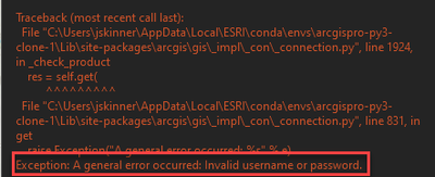

chris_del101
Hey @JakeSkinner
I'm replying to a post above from 12/17.
Here is the screenshot of the login panel
My username has no special chars and is being input correctly.
Enterprise 11.3 and Pro 3.4
This the latest. I input the info and it just keeps loading with dots across the top. This is the error and screen. I can't even get the data to load. It just does this until I close it
So I close it and restart Pro and I get a different error.
JakeSkinner
@chris_del101 do you have a different admin account that you can try?  Preferably one that does not begin with numbers?
chris_del101
Hi @JakeSkinner,
So I've been able to get it to work with said admin account, but then I need the source and target to be the same portal. This would be okay for testing, but then I get this error when I try to clone.
Exception: {'message': "Service name 'chris_copy_Xact_Polygon_Map' already exists for '0123456789ABCDEF'"} ...
targetService = fgd.publish(overwrite=True) ...
Exception: Analyze Service error: Server tool execution failed : ERROR 000800: The value is not a member of SHAPEFILE | CSV | EXCEL. Failed.
(Error Code: 0)
 I only have another admin account with numbers at the start. If that's the only problem here then I can try to get another account.

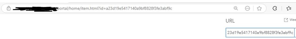

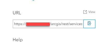

@LeeHwang first start with the web map.  Can you verify the data sources in the web map were mapped correctly to the new data sources in the target environment?  For example, go to the web map details and click on the layers:
Is the URL at the bottom right of the page pointing to the correct URL?
LeeHwang
New Explorer
@JakeSkinner Yes, the layer found in the web map details page takes me to the details page of the map image layer being referenced.  I'm able to view the map image layer in Map Viewer but not the web map in the Map Viewer.  The domain of the URL of the Map Image Layers is correct and referencing the new machine.

GIS_Limburg_Province_Belgium
1. Positive.
2. I do not know (did not develop the app myself), but the url (source portal) says:
https://<xyzxyzx>/portal/apps/instant/minimalist/index.html?appid=b70529dd0e794008aefb2650224557b7
3. See below how I filled the form. I left the Environments tab untouched.AGE2.jpg
JakeSkinner
@GIS_Limburg_Province_Belgium try removing the /home/ from the Source AGOL/Portal and Target AGOL/Portal parameters.  Also, I've seen some issues when you do not click the Tab key after specifying the New Web Map ID.  Place your cursor in this box and click Tab on your keyboard.
I did what you say. Now, the url of the target app is correct (referring to my remark and picture yesterday). But the app gives a blank page if opened.
JakeSkinner
@GIS_Limburg_Province_Belgium use the AGOL Assistant and check if the new web map ID is being referenced in the app's JSON.
@JakeSkinner : yes, the new web map ID is being referenced in the app's JSON. Checked it.
Problem solved. App is running now. The show stopper was the picture that appears when the app starts: it did not migrate. I did not realize that, thought it also migrates automatically.
Thanks Jake for your useful tool and your assistance!

I have an error, about the webmap script.
I am trying to clone webmaps, but for some maps I am receiving  an error message:
the file is CopyWebMap.tool\tool_script.validate.py, line 218 AND line 143.
JakeSkinner
@RafaelFernandesdeSouza can you send a screenshot of how you have the tool setup?
