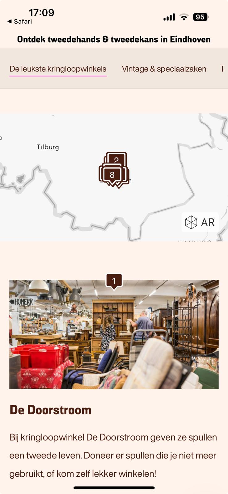

Here's what it looks like on mobile:

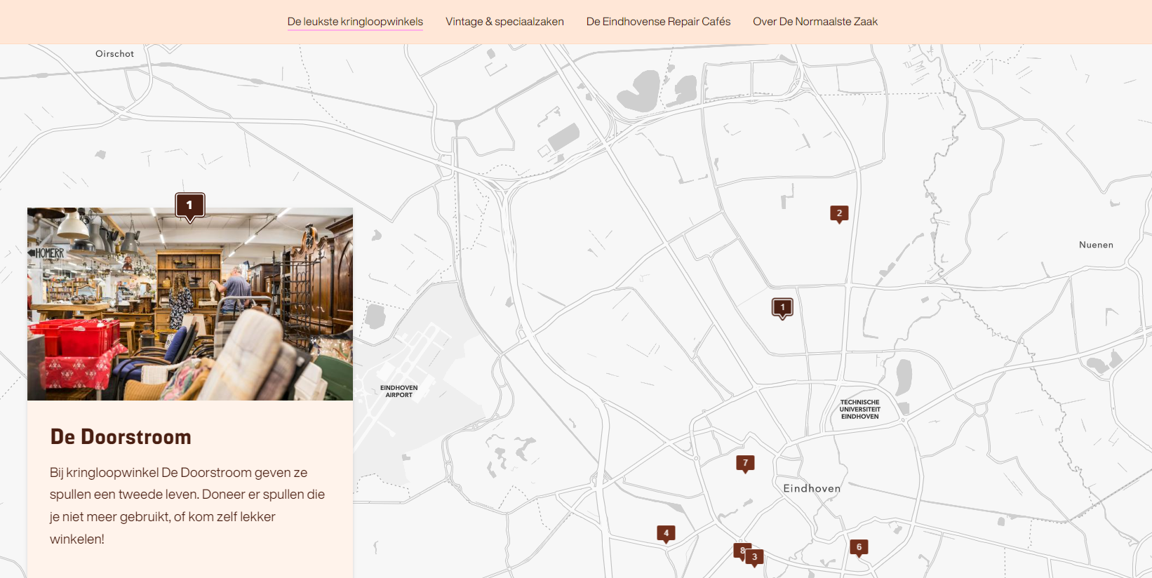

And on desktop (which is the zoom level I want on mobile as well):

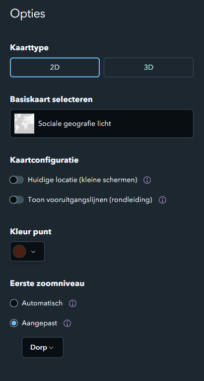

Here's a screenshot of the settings I used. It's in Dutch, but I selected 'custom zoom level' and 'village':
I also tried selecting 'current location - for small devices' in the map configuration setting, but that didn't change anything.
