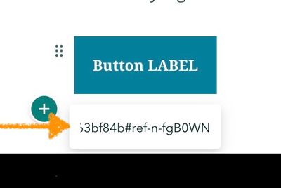

@VictoriaBoelman -- Hmm, it's working as expected when I use a button to link within a story. Are you adding the link to the button label or to the hyperlink field? Make sure you add it to the hyperlink field.
