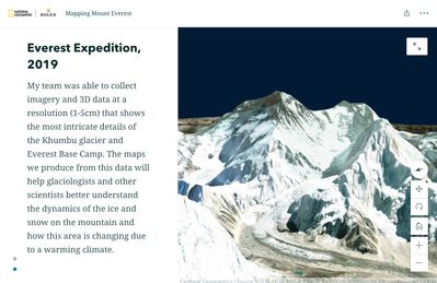

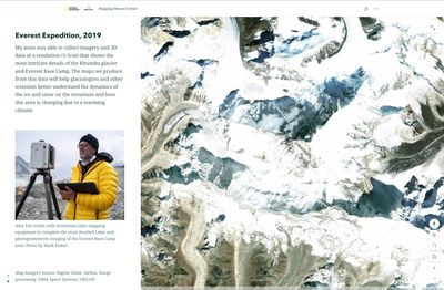

Hi @MichelleMount -- All web browsers have the ability to increase the text size. It's usually in the browser View menu and there are simple keyboard shortcuts as well.
If you are using a story as a presentation tool, simply use the browser zoom to increase the text size to something that's easier for the audience to read. Using the browser zoom is much easier and more flexible than having to manually set the size of the text in your story across different sections, and you don't have to sacrifice the appearance of the story for others who might be reading your story directly.
Here are two screenshots of the same story at the standard browser zoom level and then a few levels up...

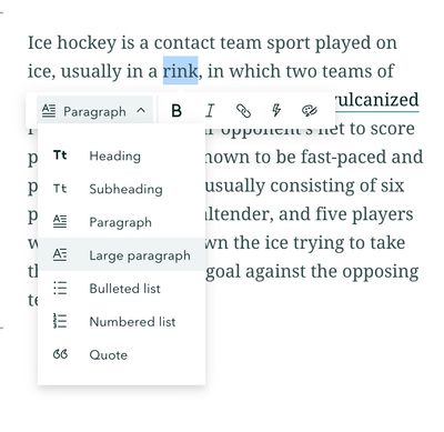

If you do want to make some text blocks larger than the others around it, you can highlight a portion of the text and choose to convert it to a Large Paragraph (as opposed to the standard Paragraph block type).
