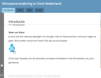

The screenshot below shows the classic version of storymaps where the functionality is available. As you can see the image is small and clickable.

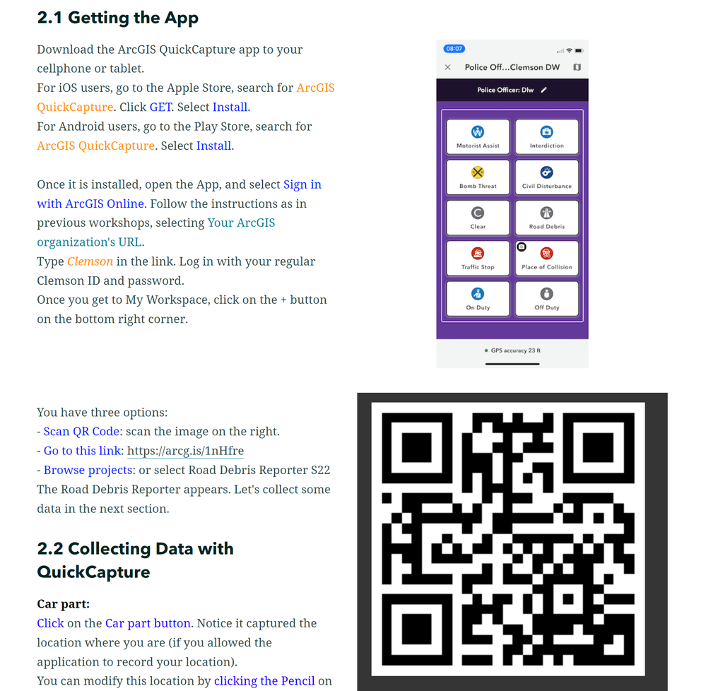

Below are two examples from two story maps where the rendering of the images could be better. In the first image, it would be great if somehow I could have both consecutive images take the same space on the screen. The QR code takes too much space and at a maximum, it should be as large on the screen as the Quickcapture screenshot.

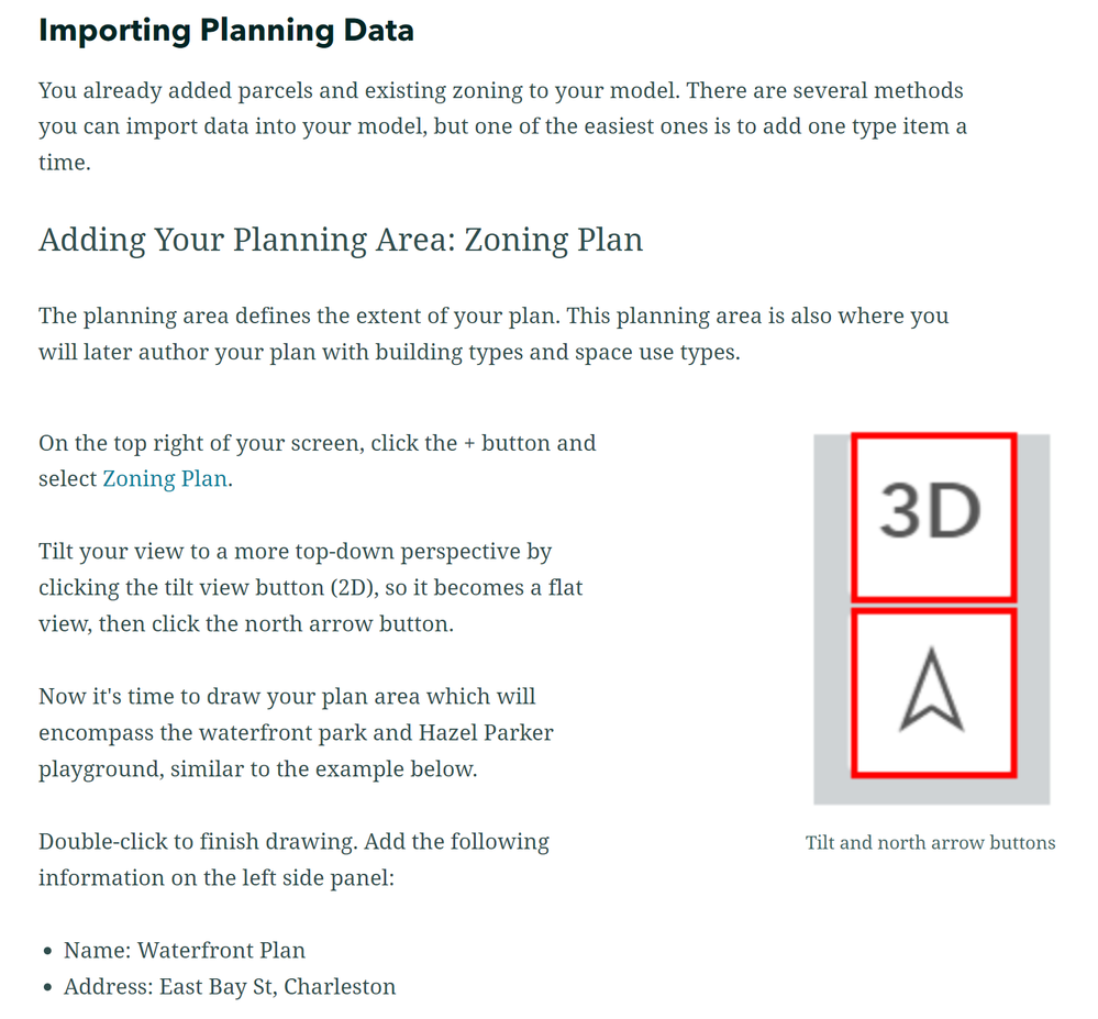

On the second one, the buttons are too large. If they took smaller space on the screen, I could stack other images for a better flow.

Relating to @patriciacdale's two great examples above, I wish the StoryMap's Image Editor supported cropping an image to be larger than its original size, and filled in the extra area as transparent.
For the QR code example, my current approach is to make all of the images I use with left- or right-alignment the same width in an external image editor. When that means cropping (not resizing) an image to a larger width than its original width, then the extra area is filled in with transparency. The end result are images that are more appropriately sized relative to each other.
patriciacdale
Thank you, Peter. That is great advice. I will do that for sure when I have images without text.
But if one of the images has text (see example of screenshot of police app at the top), trying to make them the same size as others will result in the text too big or too small compared to the text size in the rest of the page.
It would be great to have the flexibility to adjust them as needed.
