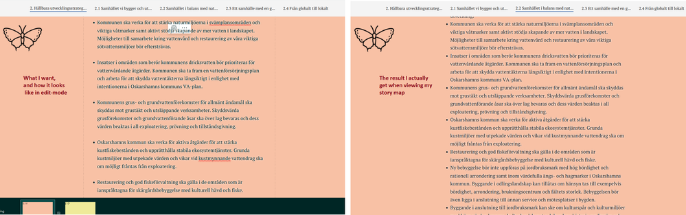

I would like this, and it seems logic to set a property in the theme. But I would like to be able to use "compact lists" as the first tree in the example above together with lists with more space as the last ones in the same story map.
I thought the introduction of "single-spaced text using Shift+Enter" in the january release maybe could solve this by allowing a shift+enter linebreak within lists. It looks like it works that way in the edit-mode, but when publishing thoose spaces disapears.

MattiasEkström
@OwenGeo  I agree that for most list with just one line, you often don't want that extra space. But in cases with long multiline lists as in this case it would be great if I could add the extra space/line with shift+Enter.
And of course we want the edit mode to look as much like the result as possible, so however blank shift+Enter lines is handled it should be the same in edit mode as in viewing mode.

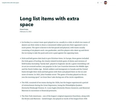

OwenGeo
@MattiasEkström -- I just did some testing and I believe I was able to create the look you are going for simply by treating each bullet item as its own list.
At the end of each list item, I hit ENTER twice at the end of one list item to end that block and start a new block, then I started a new list block for the next item. Is this what you're looking for? This is a screenshot from viewing the story.

MattiasEkström
@OwenGeo-- I did some more testing and this is a story map with my test:
Test bullet lists (arcgis.com)
I'm usually pasting text from a word document and then it wasn't as easy as just hitting ENTER twice to create new blocks to make it seperate list. But if I copy one item at a time I can achieve this with new blocks for each item. But then I do end up with not one list, but many list with one item each and it looks visually good, but my concern is that this solution is inappropriate from an accessibility point of view.
