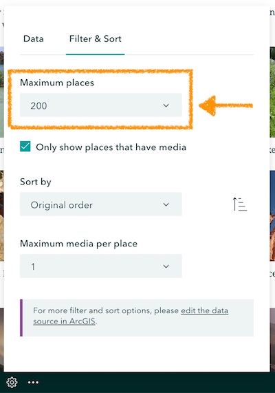

In the Sept 8 release of ArcGIS StoryMaps, the limit for data-driven tours (tours created using a feature service) was increased.
The previous limit was 100 places. While the number of places initially shown in the tour remains at 100, there are two new options under Maximum places on the Filter & Sort tab to show 150 or 200 places.
For more information, see What’s new in ArcGIS StoryMaps (September 2021) (esri.com)
