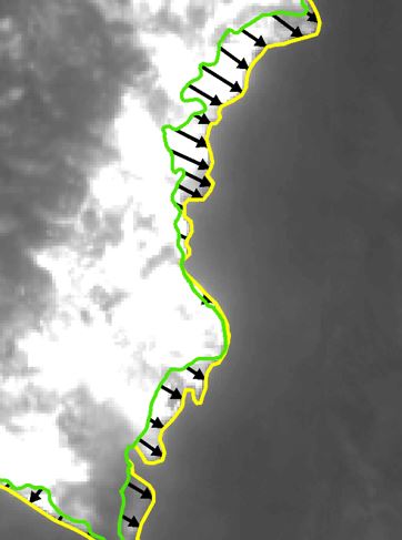

I have two 'base' line features that are somewhat parallel to each other, which are connected by vectors (also line features) [Check attached photo - underlying raster layer is not the DEM].
I want to use the vectors connecting the two 'base' lines to extract slope values calculated from a DEM. In other words, the vectors connecting the two 'base' lines are spatial sampling units, which will be used to extract topographic information to describe the movement from one base line to the next.  This is obviously problematic, since ArcGIS's slope tool only calculates slope directionality in terms of a convolution 3x3 kernel, which in turn, gives an output in degrees or percent rise....So. When I use the vectors to extract the slope values along each one (individual vectors),  there are obviously no negative values, when in reality, these vectors all have some sort of mixture of negative and positive slopes ( because many of the vectors from base line 1 to base line 2, go up and then down slope, or vice-versa).
My question - What algorithms can I use to transform the slope values based on some relative starting point of each vector, so that once I extract the slope values from each vector line - it will illustrate whether that vector was going predominantly downhill (negative slope) or uphill ( positive slope)?

You say you don't have the DEM? Can you not get the one used to produce the slope raster? or a surrogate for the area?  The solution would be to find that data to extract the elevation values.

Thanks for your response. I do have a DEM with the associated Aspect, Slope (both degree & %-rise versions), and Curvature outputs. Yet, when I use the vectors to extract such values, its misrepresented. Am I making sense here?
e.g.- one of the vectors travels predominantly downhill between baselines 1 and 2 - I extract the the slope values directly from that particular vector, yet the extracted values are positive...when in reality, the vectors total slope from its start at baseline 1 moving to baseline 2 is actually a negative slope.

When you extract using the vector, you should extract the elevation data to use it as a guide as to whether or not the elevation, hence slope, is increasing or decreasing.  However, since you have a direction of travel along a vector, you might be able to repurpose aspect to give you a guide.  For instance if your vector is travelling from west to east along a constant slope whose elevation is increasing, the aspect is 270, then the slope is pointinto the west and the vector is going uphill.  An incremental move to the east will show a decrease in slope but a fixed aspect.  At some point, if you begin to go downhill, the aspect will change eventually reaching  90 degrees, since the vector is going down hill and the slope will incrementally increase.
  More complicated calculations can be done in numpy, in fact, slope aspect and other terrain derivates can be assessed using it.  Consider this small DEM with D8 slope and aspect calculated using numpy.  Pay attention to the line
Slope....   [45.   26.57  0.    0.    0.   26.57 45.  ]              Row 15
Aspect...  [270.   270.   270.   270.   270.    90.    90.  ]   Row 23
