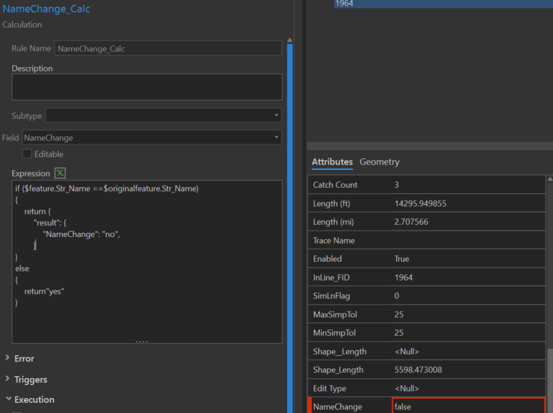

Hello,
I am new to arcade expressions and I am attempting to make a new attribute rule for a Stream polyline feature class. My goal is to track when a features name has changed. Where, if the Stream Name field (Str_Name) is updated, then another field (NameChange) within the same feature class table is updated to say Yes.
I have looked at some other resources and think that I am close, but I keep getting "False" instead of Yes or No.
Here is a snip of the attribute rule. I am using an Immediate Calculation Rule.
Any help would be appreciated.
Thanks!

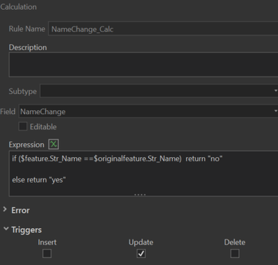

 Sure, no problem
JoeBorgione
MVP Emeritus
Simple and elegant!  I've never had occasion to use the $orginalfeature global, but it looks like it can be very helpful.
