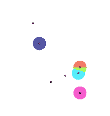

the 10.x and older pro behavior for expand is different than euclidean distance. See the example below. Also, specifying the zone values that you want as inputs may be a pain.
For pro (2.6 i think), we added a 'distance' expand method which might do what you want (but you still need to specify the list of zones).
another approach would be to use the new DistanceAllocation tool with an accumulation cutoff for the distance you want. Or Distance Accumulation followed by Con...
