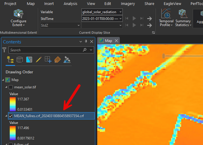

@RyanDeBruyn  I ran this analysis again against a GPU with 48 GB of dedicated memory without downgrading resolution and it completed in 50 hours as opposed to 72 hours at coarser resolution. I've published image services of the resulting rasters and am very happy with the results.
One question I have though: why does the output of a mean summary statistic from the multidimensional toolbar produce a .crf if different dates are no longer present? The sum statistic does not produce a .crf.
RyanDeBruyn
Hi @GBacon glad you are having some success.
"Why does the output of a mean summary statistic from the multidimensional toolbar produce a .crf if different dates are no longer present?"
The result of the summary statistics is an aggregated output and we maintain the consistency of the output format as a multidimensional raster, even though as you mentioned the data has only one result (mean values) from all time slices.  This does also help to make clear the properties of the data from the analysis. The result .crf should not be any different or affect any subsequent use.
Note: You can run similar results using the GP tool Aggregate Multidimensional Raster (also found in the MD ribbon) where the result may differ in the number (count) of output slices.
