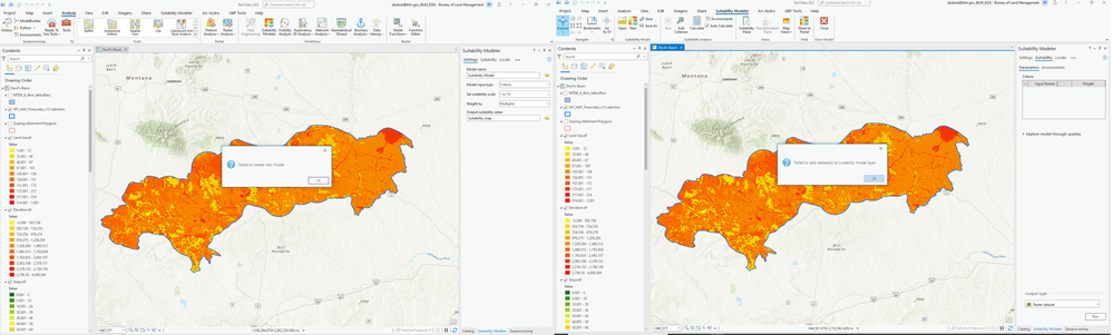

ZaaraKidwai
This is what it looks like any time I am trying to do anything whether its launching the modeler or adding raster files.
