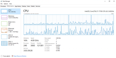

I'm having better luck with the new Pro 3.2 raster solar radiation tool that can use GPU and parallel processing - I just don't understand the tool parameters and outputs as much as the old one. The .crf output format seems like it has some nice possibilities, especially if I can publish it as an image service.
CPU:
GPU humming along nicely too.
robertkalasek
@GBacon ... well actually i am not really impressed by an overall 16% utilization-indicator. would be interesting, what the processing-time benefits are. have you tested without parallel processing ?
