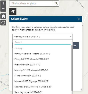

As far as you know, is there a way to restrict which events are visible in the Special Event Site Map application? I'd like for users to only see the site maps which are relevant to them.
If it's not possible to restrict event visibility by group, is there a way to remove events from the drop down list without deleting the events all together? Changing the status of an event to "archived" does not remove it from the drop down. This is the drop down I am referring to:
Chris_Delaney
Hi @mshanaghan ,
You can filter the list of events displayed in the Special Event Operations Map filter by opening the Special Event Operations Map and placing a filter on the Special Events layer- a filter like "Status excludes Denied and Archived" might do the trick!
mshanaghan
Great idea! Thank you!
