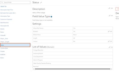

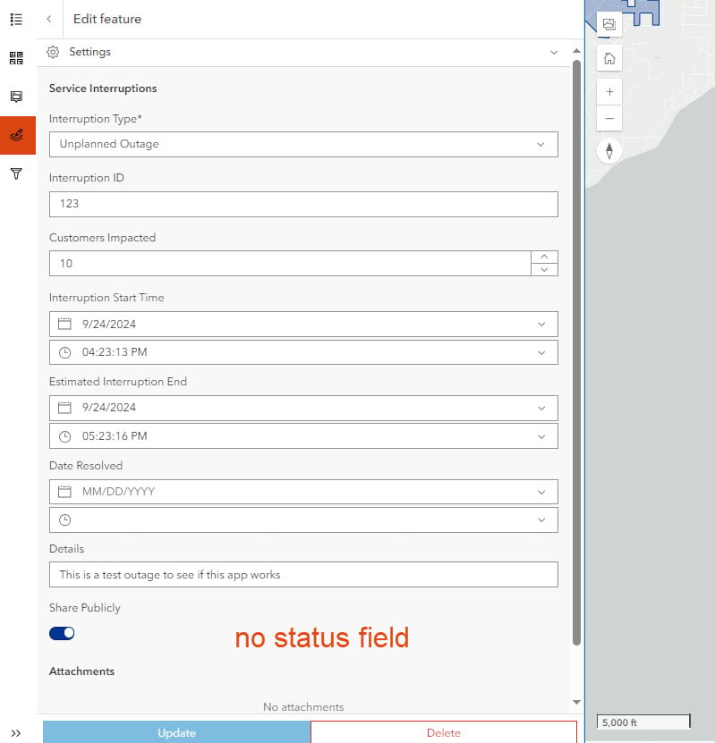

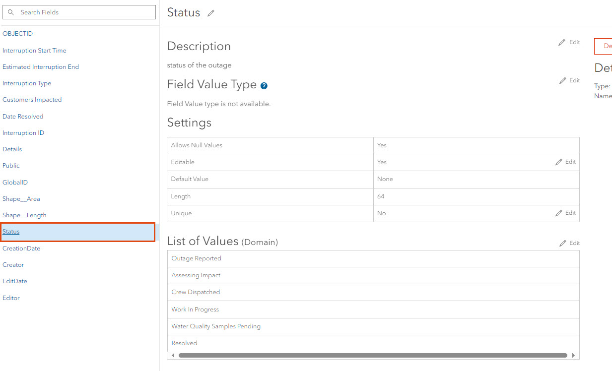

Recently deployed the Water Utility Service Interruptions solution and am currently configuring it. I want to add a STATUS field so that managers can update the interruption status for viewers. I have done this in the feature service. However, it does not show up in the edit tool of the Water Utility Service Interruptions Manager Web Mapping Application.
I am the owner of the feature service and solution, and I am a Creator.
Here are some pictures of what I am seeing (or not seeing).

The new field needs to be added to the Form in the Map settings. Here is a recording of how to do that. I added the Status field just as you have and show it missing then add it in.
Also, if you want the Status field to show on the public viewer you'll need to add the field to the view.

Thank you so much! Thats exactly what I was missing.
