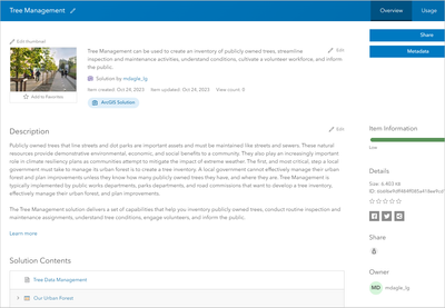

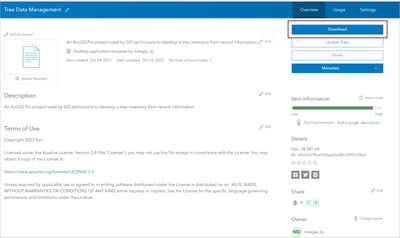

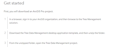

Step one and two say to download an copy of the project from Online.
However, I don't see a way to do that. Am I missing something?
MikeDagle
In the screenshot you shared, just a little lower, click on Tree Data Management.
Then on the item details page, click Download. (Or you can search for Tree Data Management, or navigate to it in your contents. All of the items deployed will be in a folder called Tree Management)
