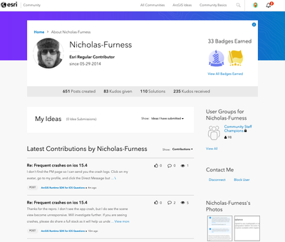

YoussefMAHERZI
No such button on your profile, neither an enveloppe on top of my screen as mentioned in the help page.

Nicholas-Furness
Thanks. That's helpful, and strange that you don't see the DM option. Sorry about that.
