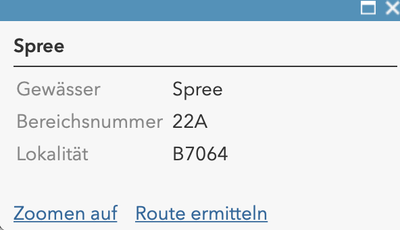

So when I open one of the Web Maps in ESRI Portal and look into the data I see that there are some pre-selected properties, that also have some customized aliases:
Tapping onto one of the features I see, that ESRI Portal gives me the pre-selected props with the customized alias titles (I'm also wondering where the title Spree comes from).

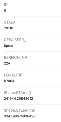

Now in Runtime iOS SDK: if I create a new `AGSPopover` from the selected feature and feed that into `AGSPopupsViewController` via
let popups = didTapFeatures.compactMap { AGSPopup(geoElement: $0) }
let popupsVC = AGSPopupsViewController(popups: popups, containerStyle: .navigationController)
self?.present(popupsVC, animated: true, completion: nil)
I get this (ie no customized aliases and also too many entries):

`results` consists of 1 `AGSIdentifyLayersResult`, with 0 geoElements, 0 popups, 1 subLayerResults and the subLayerResult consists of 1 geoElement, 0 popups, 0 subLayerResults. GeoElement is of type `AGSArcGISFeature`. So there are no popups, which is why I create the `AGSPopup` from the geoelement... Setting `returnPopupsOnly` to true of course results in 1 results, with 0 of everything (geoElements, popups, subLayerResults).
I tried that on various Web Maps / Mobile Map Packages and always the same: ESRI Portal / ESRI Explorer App shows nice simplified popups, with my request I get 0 popups and creating the `AGSPopup` from the features myself returns in un-customized too-much-data popups...

From your screenshot of the portal map viewer, I wonder if the layer has a popup defined, and this is just a question of default behavior when a popup is NOT defined. The title "Spree" probably comes from the service's displayField property.
Can you check and see if there is actually an explicitly defined popup in the web map?
