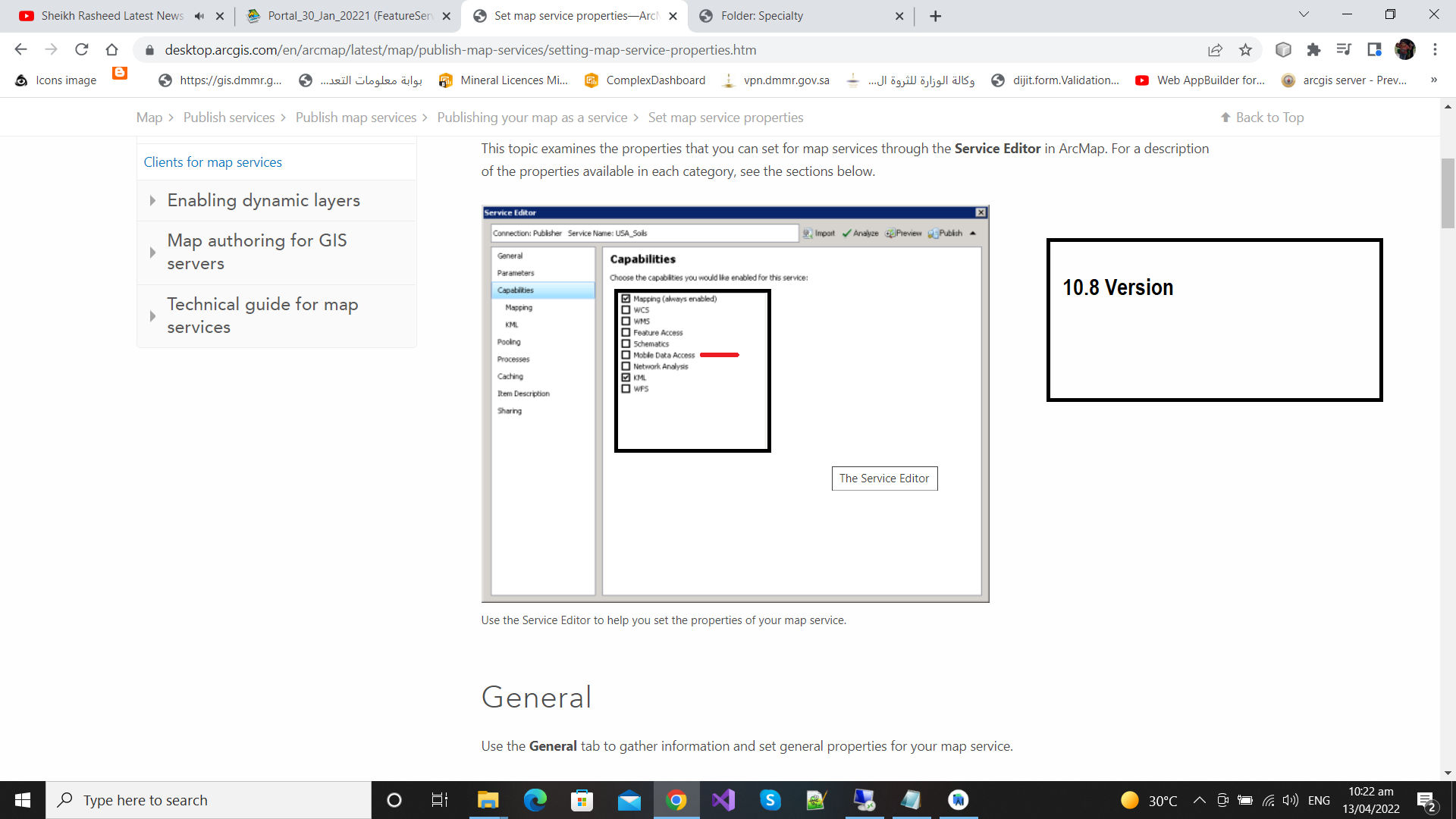

map visible on mobile.it shows that some problem in my rest service.when i troubleshoot i check that "Mobile Data Access" in capabilies is missing in my
arcgis server missing.My arcgis server is 10.7.my arcinfo is 10.7.for this i am adding image Mobile.png
so please help me.why arcmap or arcgis server missing this option.

Hi,
Can you print your load error for the layer and see the exception and its cause/message ?
mapImageLayer.getLoadError()
Thanks
