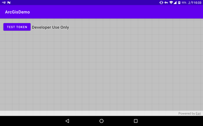

i'm new arcgis.
I have two question.
first, i can not find ArcGISTiledMapServiceLayer class in
arcgis-android:100.13.0
 second. i replace use ArcGISTiledLayer and map does not show
 any can help me thanks

Hi,
I got err log:
No data tile ETag couldn't be retrieved
ArcGIS.TileCache: EsriServiceException:8,204,36: Response Code=:403
