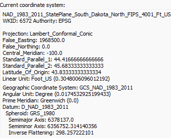

I'm prepping our LRS for transitioning over to R&H, and I'd like to know if I should change the default M tolerance and resolution. Our current LRS specs are below:
Our events are only measured to thousandths of a mile (3 decimal places) and there is no exception to this, so what is the point of having a more precise tolerance/resolution? What do other organizations set as their defaults? It just seems like it would keep the data "cleaner" to not allow measures more precise than the event data, but I would love to hear other thoughts on this...TIA!
