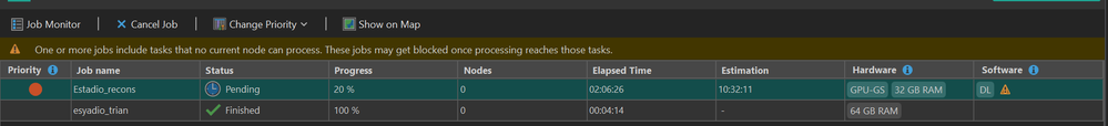

I’m trying to generate a Gaussian Splats layer in Reality Studio. When I start generating it in the Job Monitor, I get the following message:
“One or more jobs include tasks that no current node can process. These jobs may get blocked once processing reaches those tasks.”
At first, it seems to start processing, but when it reaches 20%, it freezes. I have the latest version of Reality Studio installed and I’ve already installed the Deep Learning 3.6 libraries.
Does anyone know what causes this error or how to fix it? I’d appreciate any suggestions.

Hi @idanitorres18 ,
Great to see you are interested to generate Gaussian Splats with Reality Studio!
Deep Learning libraries are product and version-specific. Thus, the libraries for Pro 3.6 are not compatible with Reality Studio. You can download the Reality Studio 2025.2 Deep Learning libraries from My Esri or from this github repository.
You can also find more information in our help documentation: Install deep learning libraries for ArcGIS Reality Studio | ArcGIS Reality Studio Help
Let me know if this unblocks you or if other questions come up!

Hi, Camilo,
Thank you very much for the observation. With the installation of the correct libraries, I was finally able to generate the Gaussian Splats!
