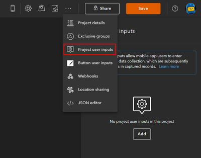

Hi Katie,
Yes, this will work. You just need to create a project user input in Settings:
Once it’s created, you can select one or more buttons in your project, go to the Data tab, and apply the project user input to the appropriate field. The same project user input can be used across multiple buttons, even if they send data to different layers.
The only requirement is that the field you’re updating is a text field.
Let me know if you run into any issues.

Many thanks @JohnathanHasthorpe I had originally set up domain lists on the separate layer fields (all containing the same domain values), but I think this is what was causing the issue. If they are just text fields (with no domains set) this works as you describe. With the domain list them just being able to be assigned on the project user input field.
Many thanks
