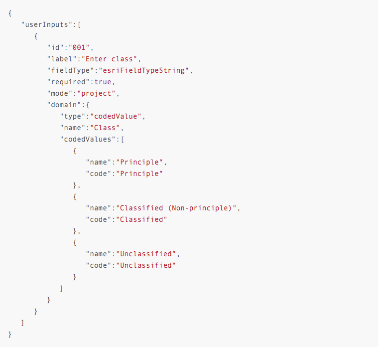

From 1.7 you will be able to create lists for project user inputs. This means the user of the app will be able to select from the options yes and no. This is possible in 1.6, but you will need to edit the project JSON in the designer's JSON editor. See: Project JSON—ArcGIS QuickCapture | Documentation
The following project JSON example shows how a codedValue domain user input is defined:
If the codes in the JSON match the codes in the feature layer field, then the app will be able to submit them.
Thanks
John
