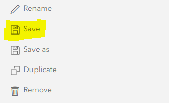

  1. Regarding the symbology edits issue. After applying the style/symbology, make sure you Save the changes on the layer and then create your QuickCapture project from this layer. If it still doesn't work, can you try symbolizing the layer with the Map Viewer Classic again and let us know if works?

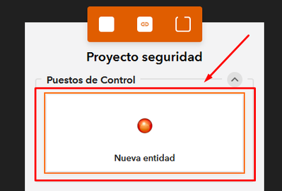

Hi @Mandy_Li thanks for the reply. So usually when I've set up QuickCapure projects in the past I've pre-set the symbology in the visualization tab of the feature layer from a field which I've set a domain list as you can see in the first screenshot, which is fine.
In QuickCapture Designer I would then start a new project from this layer and select create buttons from layer symbology which I thought wasn't usually greyed out as shown. Usually in past projects this would then create buttons for each item in the list which I could then customise but instead since last week I only get the one button for a new feature as shown.
I don't think I'm missing anything and this is how I've done things in the past based off Esri videos I've watched but I could be mistaken. Thanks.
