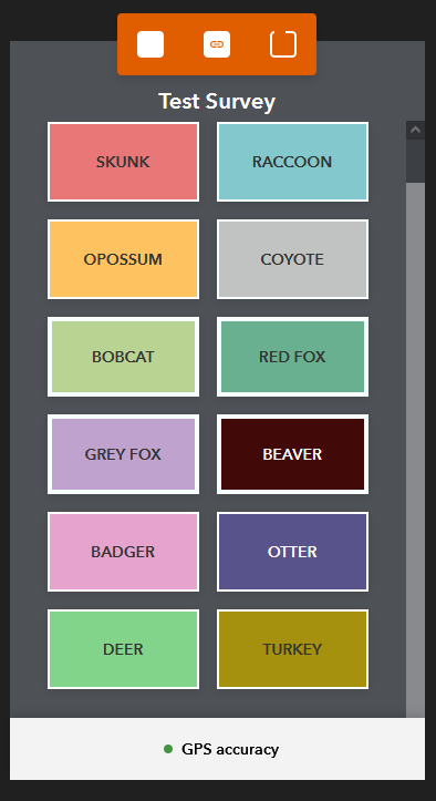

DavidMurray_ODWC
My agency uses iPhones.  ...Mine's a bit newer than some: iPhone 6s Plus; iOS c 15.7.5.
I took the "Debris Reporter" Template, and tried to edit it for a 'roadkill reporter.'
Button Labels:
SKUNK
RACCOON
OPOSSUM
COYOTE
BOBCAT
RED FOX
GREY FOX
BEAVER
BADGER
OTTER
DEER
TURKEY
The text being saved in the 'debris' field is the same as the button label.
Altering the recorded text doesn't seem to make any difference.
