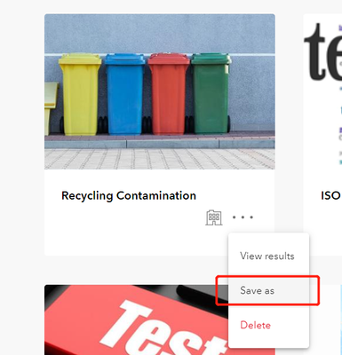

In QuickCapture Designer, you can quickly make a copy of an existing project using 'Save as'. Once you have the copied project, you can continue to update it to meet your needs, which in your case, is to rename the title, change to another basemap, and save the project.
'Save as' is a very handy tool if you want to make a similar project to an existing one, but don't want to start configuration from scratch.
Let me know if this 'Save as' idea works for you. Otherwise, theoretically it is also possible to automate project creation and update process with REST API, although I did not test it out before.
