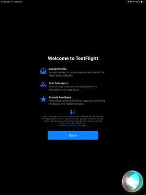

AndrewPadilla
Hi Johnathon, I attempted to use the link but am unable to "Sign In". From the quick research on TestFlight sign in issues, it seems as though TestFlight is linked to an Apple ID. I am using managed device, a company iPad, which is not linked to a my specific Apple ID but through my organization. My initial test as described above was on a regular (unmanaged) device linked to an Apple ID. Unfortunately, I don't have an unmanaged iPad to test the Beta version. I will see if there is anything I can do on the from my end and update this post with what I find out.
