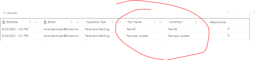

We have a project that's about to go live and it appears that the latest update to ArcGIS QuickCapture may have broken a functionality we're depending on.
We're leveraging url parameters to open the mobile app, when opening the app the parameters are not bein passed and instead another "capture field" is writing to both it's designated field and the user input field.
We saw the syntax for user input parameters has changed (since the latest update for the addition of multiple user inputs) (see below). We updated the syntax of our url and the behavior above is still persisting.

Tested creating a brand new QuickCapture project from scratch and it appears to work. Therefore the old seems to be corrupted from the update.
To rebuild this app from scratch will be a pain, is there any way to confirm this behavior/resolve from your end?
