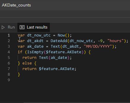

kmsmikrud
Hi,
I'm experiencing similar values but I am trying to populate a text field with a text formatted date (MM/DD/YYYY).
I have similar arcade expressions in Field Maps, that work fine, but in QuickCapture arcade editor all looks well, but when I see the written values in ArcGIS Pro they are in epoch format. I'm using app version 1.20.22 and do not have spaces in the formatted expression.
The AGOL hosted feature layer is published with UTC time and then I have been adding new fields for Alaska CreationDate and AKDate (text format of date).
Thanks in advance, Kathy
JohnathanHasthorpe
We found a bug for this issue. It will be resolved in the December (1.21) release.
kmsmikrud
Great, thanks for looking into this and I look forward to the update in December. Thank-you!
Kathy
kmsmikrud
Update December 2024. The fix worked and text formatted date is now working :)!!
