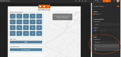

We recently discovered that QuickCapture's LocationTracking is limited to every 10 minutes. Even when editing the JSON to a lower interval, the project is restricted to none at all or 10min minimum

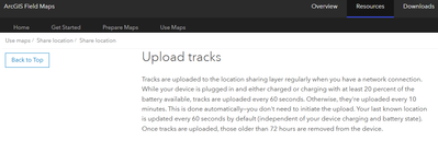

For those using QuickCapture in the field, it's imperitive that they can view their current location tracks on the map. We desprately need this solution to be equivilant with how ArcGIS Field Maps handles uploading Location Tracks:
Currently we're using QuickCapture to conduct Aerial Deer Count surveys via helicoper. It's crucial that our team can see the area they've covered in real time.

If we expose a 60 second option in designer, would this meet your requirements?

Thanks for your response. Yes, having more time options in the designer dropdown would be ideal for this product.

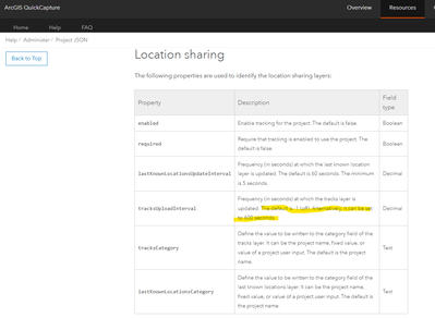

Is 60 seconds the lowest it can go? I read through the JSON documentation and it sounded like it's either -1 or 600s with no options in between:
